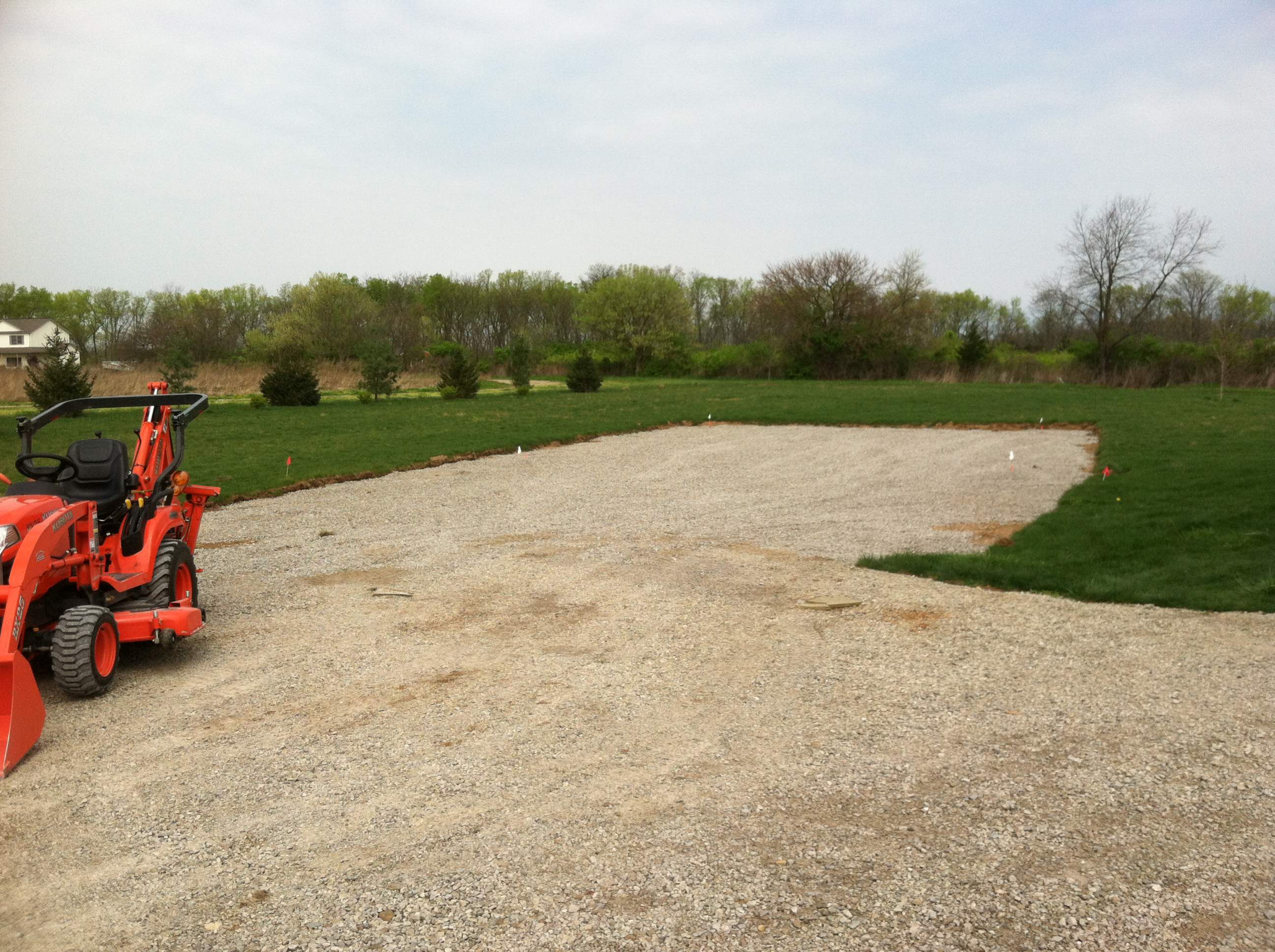

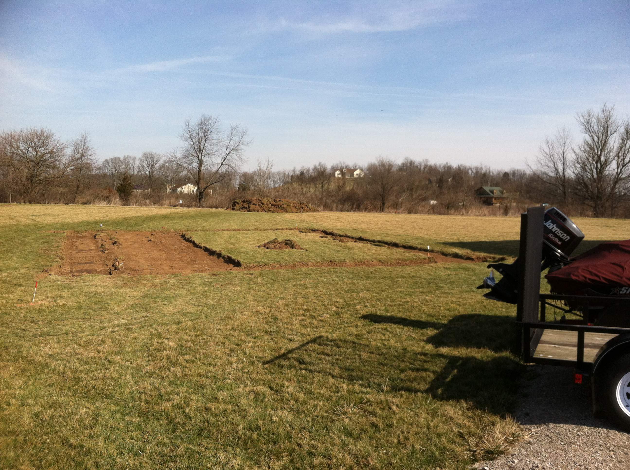

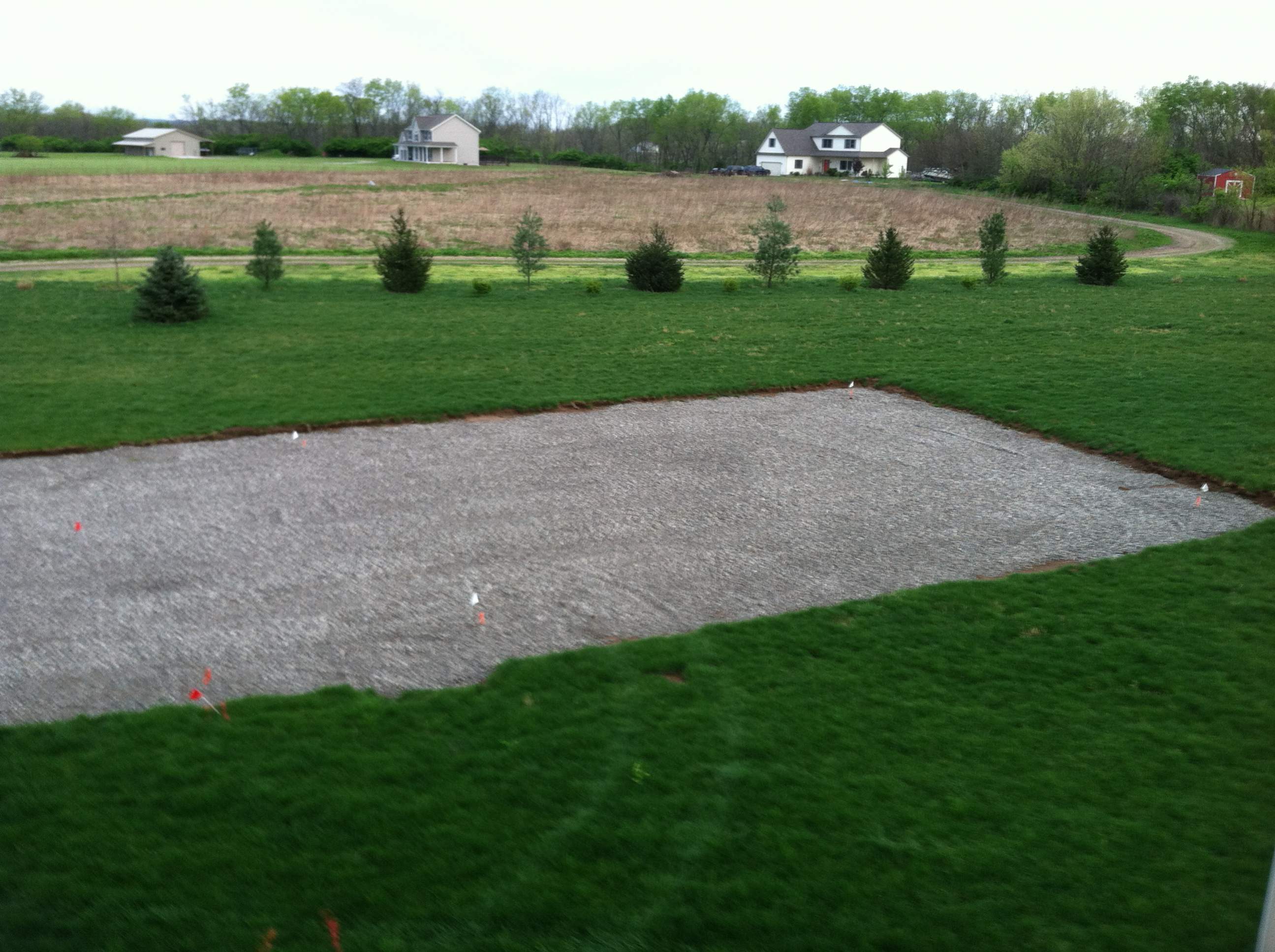

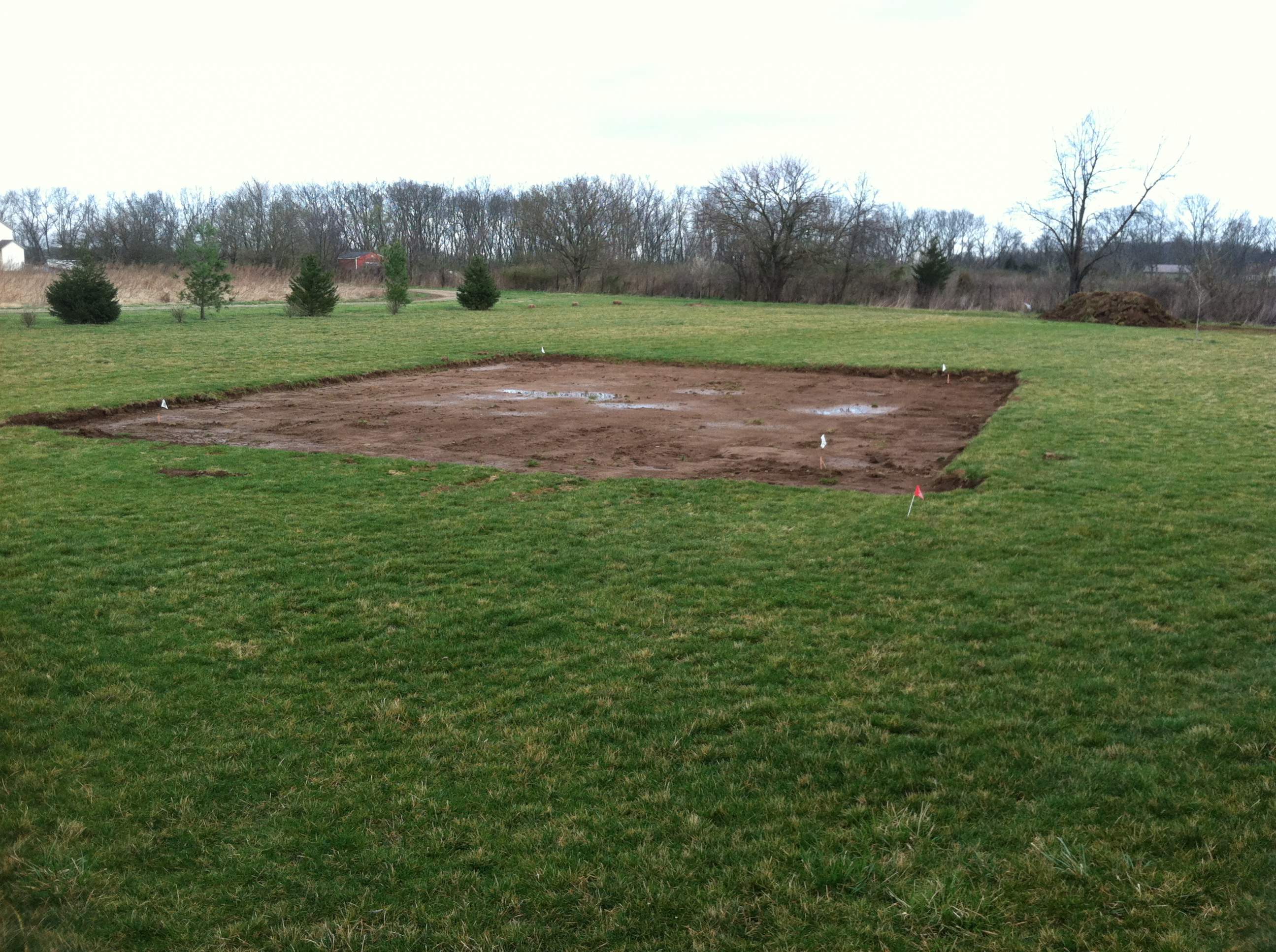

Started a new project with my BX25, it needed a home (along with all the other toys uuuhh I mean tools) Putting up a new 30 X 40 pole barn plus adding to my exsisting driveway. Started working on the pad about 3 weeks ago, the grade was within 2 inches with the exception of one corner was about 8 inches higher, have not used the bucket to dig much so I was going to put it and myself to the test, it was slow going but learned alot. I decided to dig the pad down appx. 4 inches, I didn't think about it but I began digging and it wasn't getting good bites for the the 1st couple of passes then realized it was in high, dduuhh put it down in low and man can this thing dig, as I expected it took some time because of the bucket size limitations but all in all it took about 7 hours to dig and move the material, overall area dug was appx. 40' X 90'. Once I dug the pad I went back and and lightly scrapped the the entire pad with the backhoe (broke up about another 3" deep) and back dragged the entire pad with the FEL to get a decent level and it worked great. Then brought in 22 tons of 57's and spread / backdragged for them to have a clean site to work in. I've attached a few photos (not sure how to post so the photos show in the post). Cleary Building delivered the materials Thursday and started working Friday morning. I'll post some more photos tomorrow of the barn progress......
I can tell you I knew it was a great little machine but after this little project its the best investment I've made.

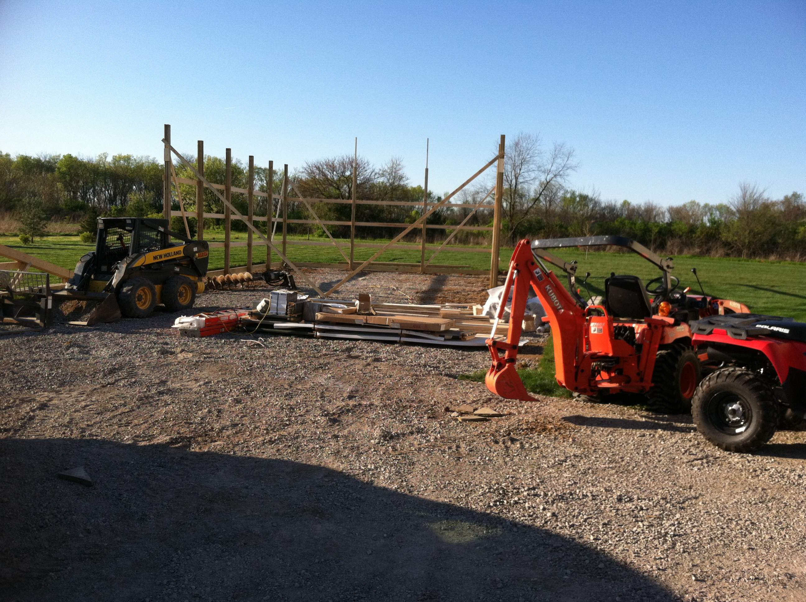

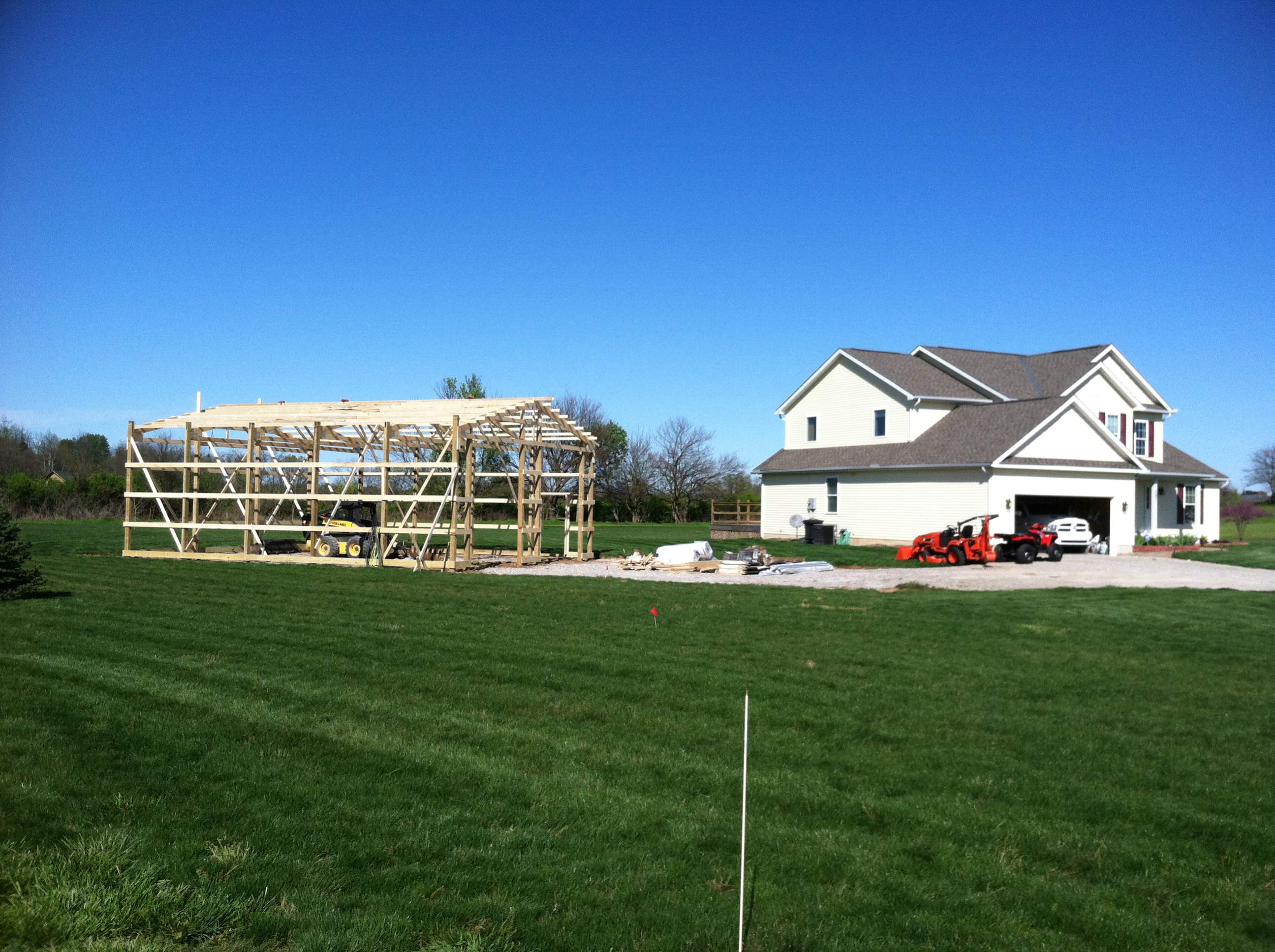

Dave, I used the FEL for all of the digging, then used the BH to break the pad up so I could backdrag and get a good level surface. Had it been later in the year, the soil would have been a bit harder to to dig so I would have used the BH to do most of the digging. All I can say is this thing is a workhorse. Thanks John and Kcender, this is my first really big project with the BX25 and its impressive, I just retired in July and never thought I'd have so much fun working again :laughing: The guys from Cleary Building started working on the polebarn on Friday, 1st thing they did was shoot the grade and the pad was within 2" all around......here's some photos of the barn progress as of today....I'll post more as the building goes up

Put a toothbar on that thing and it will even do better!! Also, after using the front loader, a boxblade would have made short work of the grading/leveling.
