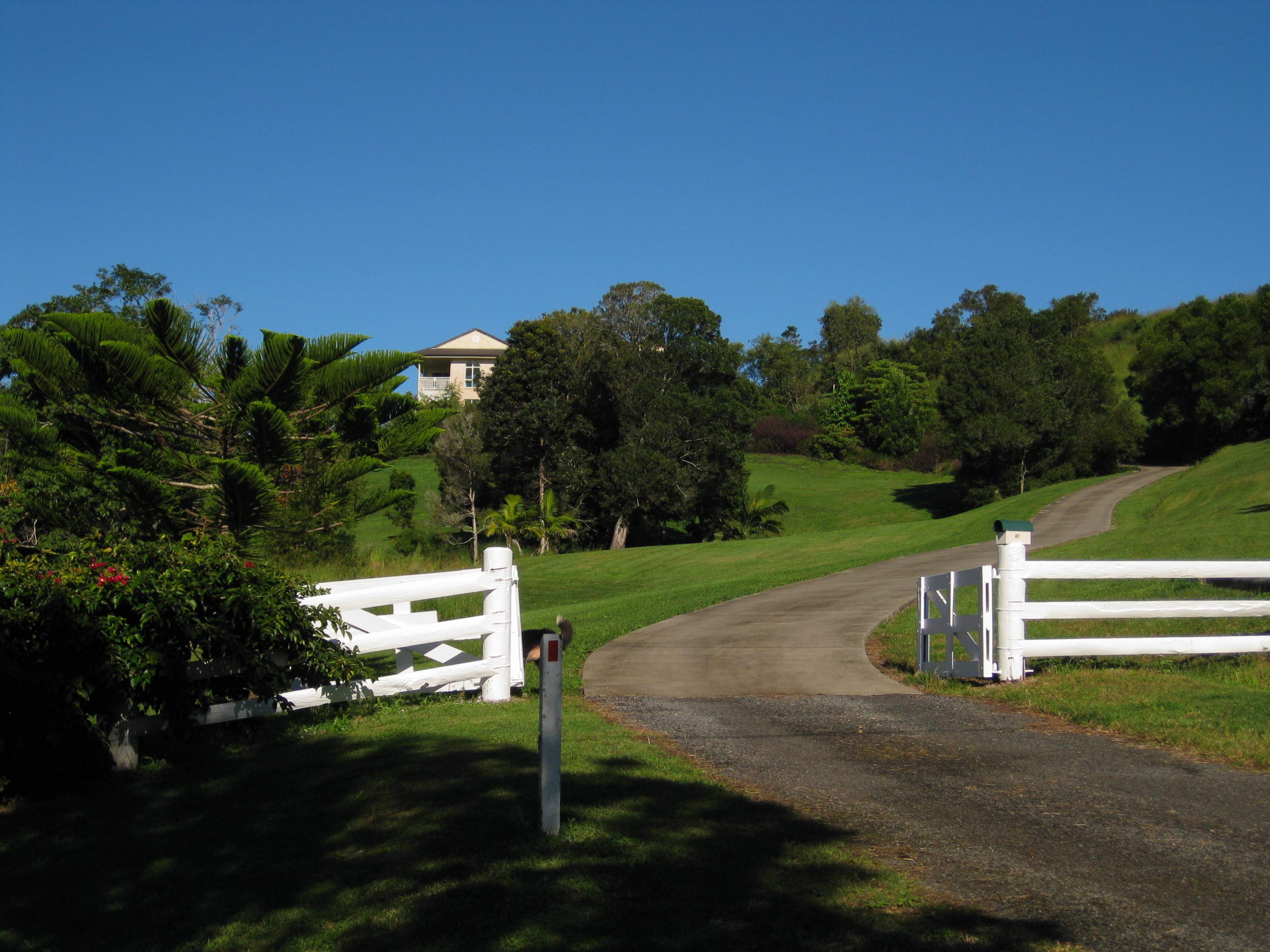

I really do think there should be a warning advice regarding NOT using
the 4wd on hard surfaces . I can feel it "wind-up" in a few feet on this
driveway ! Just trying to disengage it indicates such .That's not good.
