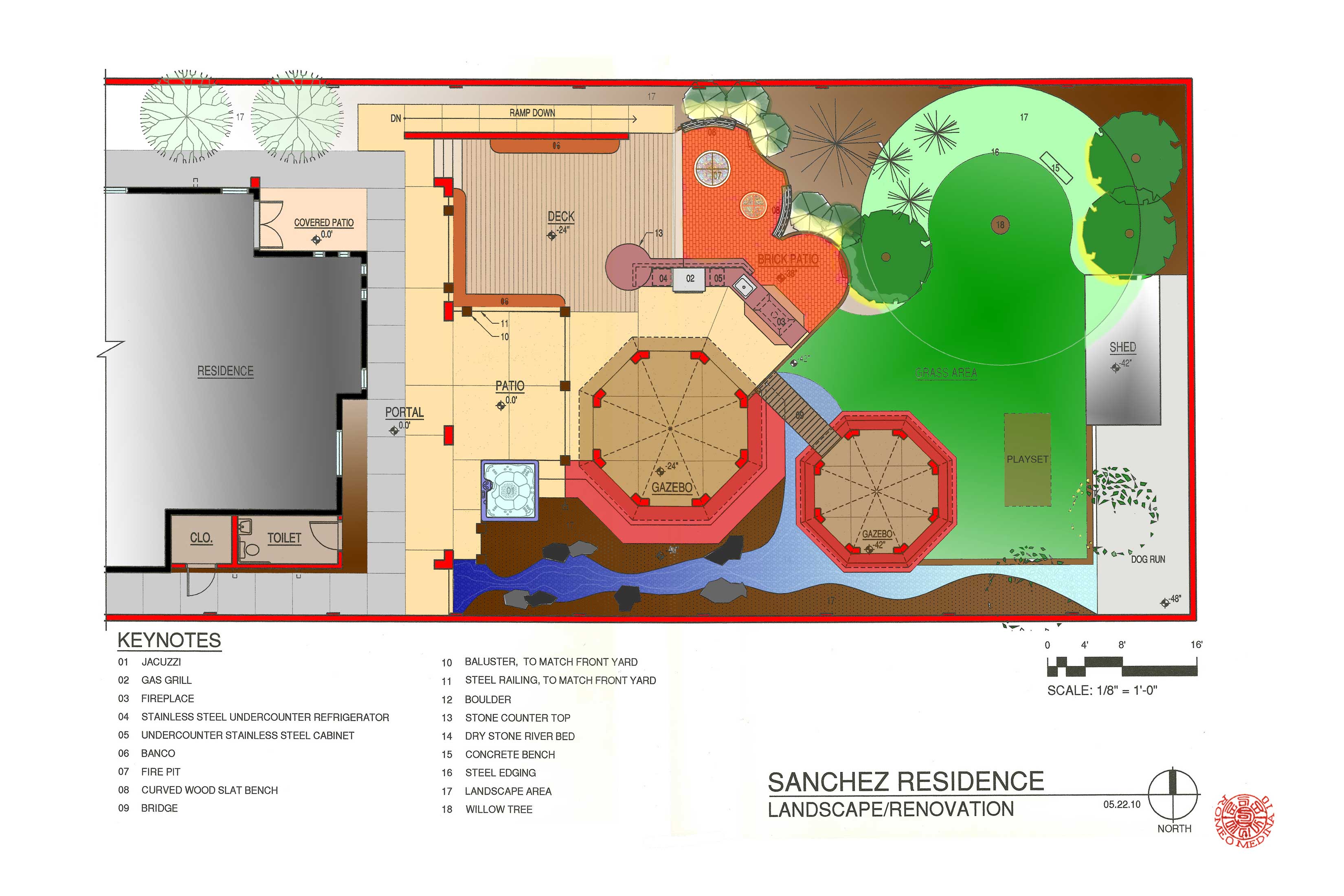

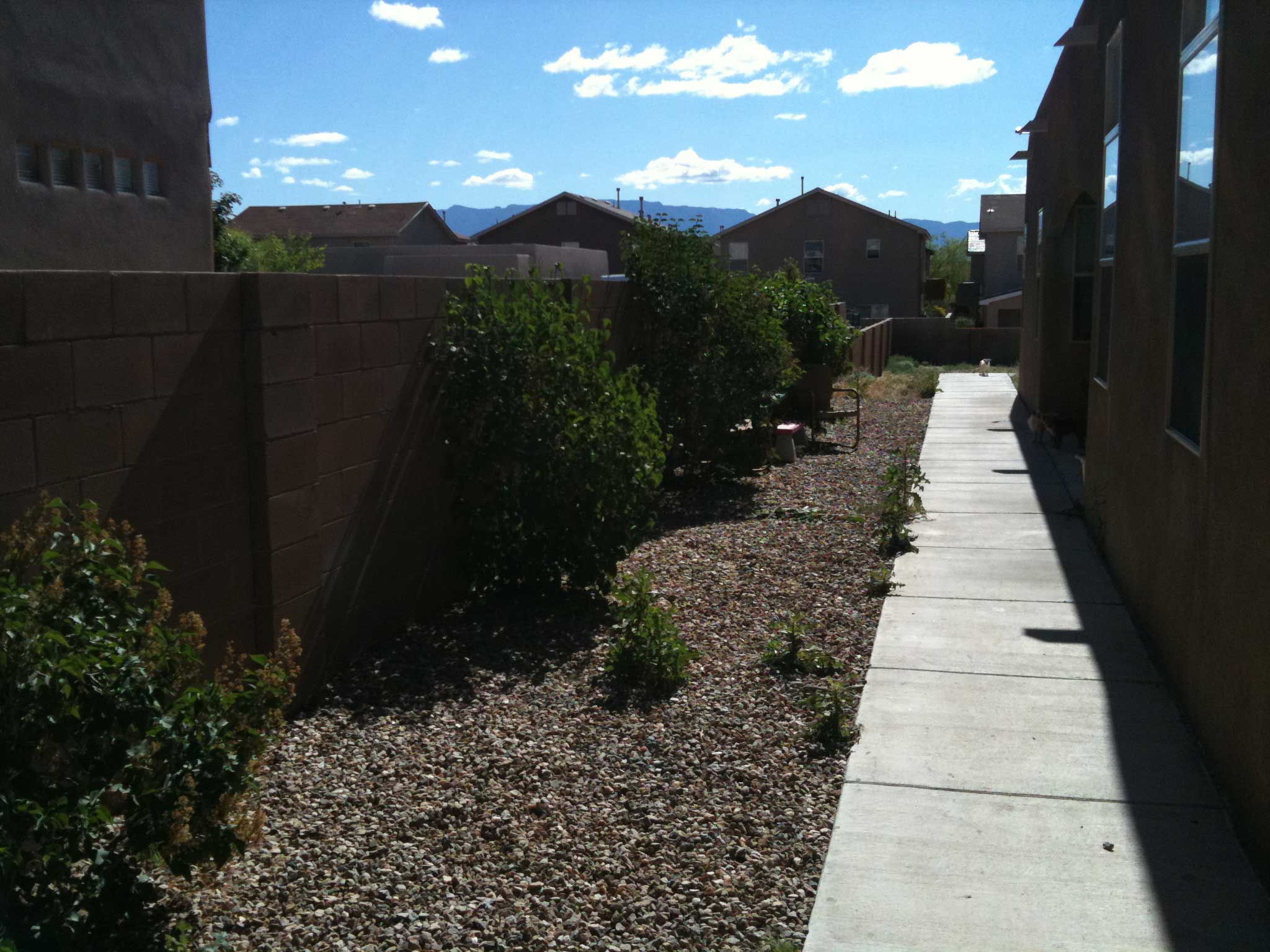

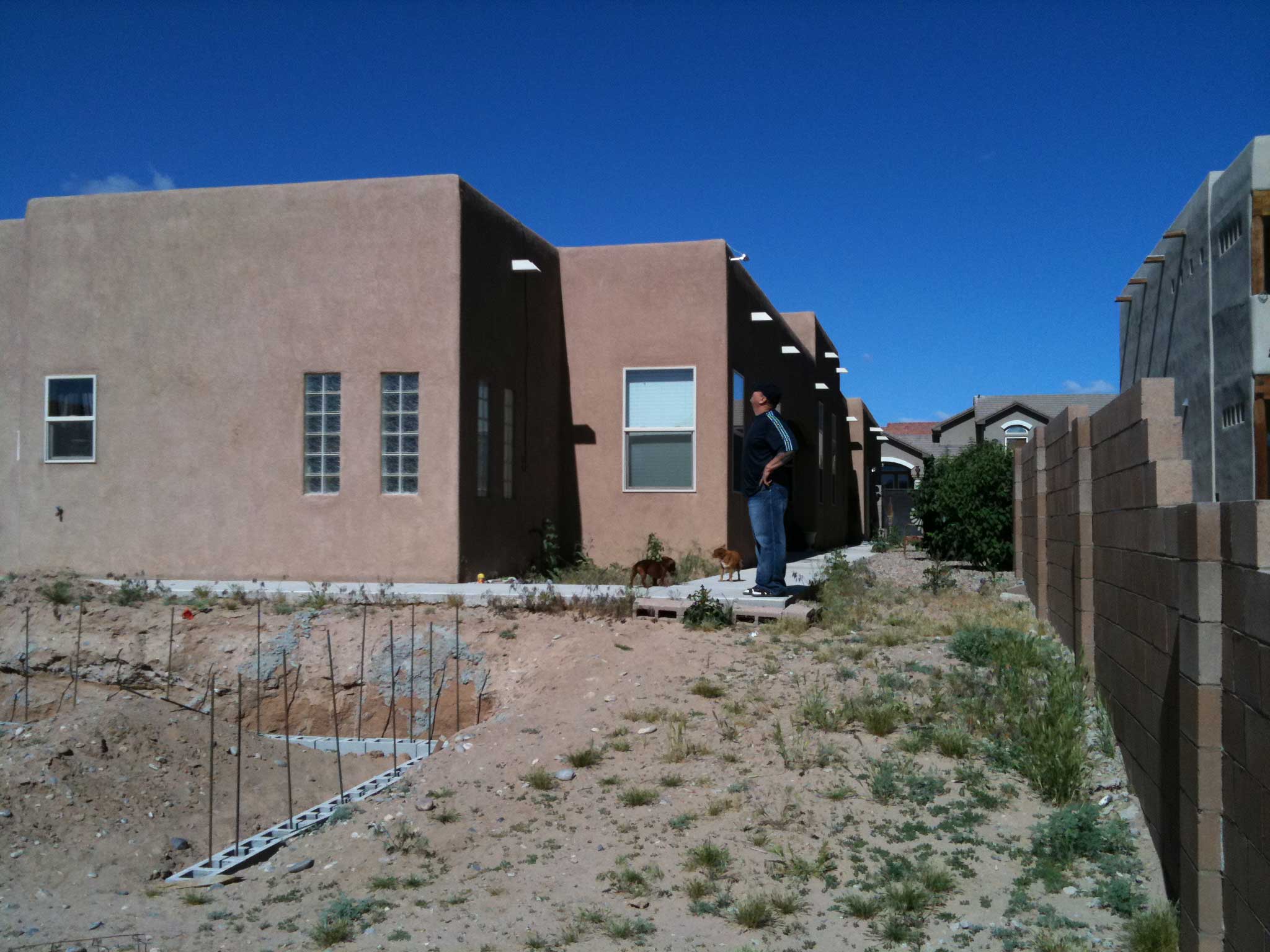

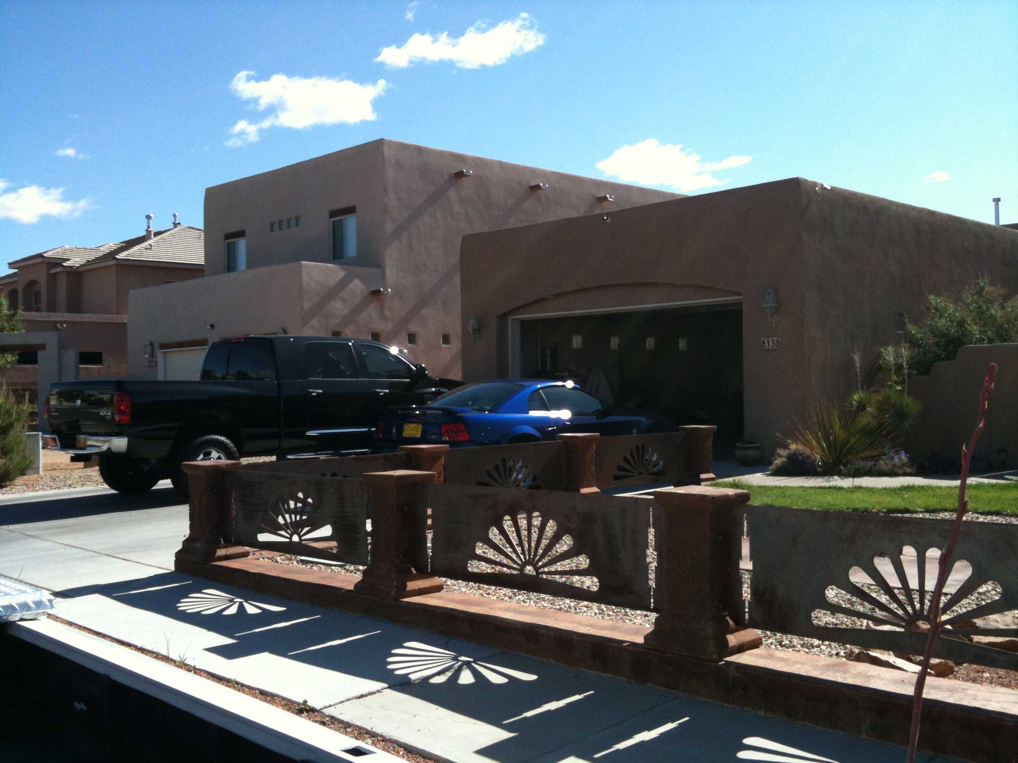

I have a Kubota BX 25 I use personally around my property. I am doing a landscape design for a client and he asked me if I can move the dirt he will have to order. It will be delivered to his front yard and have to be hauled to his back yard. It's about an average 170 feet travel distance. He has a very narrow side yard which makes the bx a prime candidate for the job. My question are:
1. How much time will it take to move a truck load of fill dirt at this distance (not including grading or anything, just moving the pile)? One truck load is about 12 tons of dirt. I need about 3 truck loads (139 Cu Yards).
2. How much is a fair rate (market price) for labor and equipment wear and tear?
3. Is it beneficial to invest in a bxpanded FEL bucket expander? Can you give me your feed back on this attachment?
Because I use it only at my house, I do not have a big enough truck or trailer for it. My client does and is willing to transport it about 20 miles.
Photos below include front, side and rear yard.
Thank you in advance for your input.

1. moving the dirt is not a problem, have you driven 200 ft with your BX, lets say at least 20 times in a row without stopping? The BX is not known for its ground speed efficiency. You noticed I rounded up the footage driven since you will need it for driving around pile, maneuvering obstacles and such. With BX, it will wear you down quick, so this being said a BXpanded bucket extender is GONNA help! Every little bit will make a difference. Do you have a trailer you could use too ? With right setup, you can load trailer, hook up trailer, drive to location, disconnect , lift with bucket to dump, go back to pile and repeat. all of this can be done without getting out tractor with 3 pt hitch.

I generally charge 100-120 per truck load to move it from the street to the back yard. I'm talking 12-14 ton loads, and every job has it's variables. This price does not include spreading, only to get it to the general vicinity of where it's going to end up. The BX hauls around 1/5 yard per scoop I think, so multiply your toatl cubic yard by 5 and you'll get an idea of total trips.
Keep your backhoe on for ballast, especially if you buy the expander, or you'll be tipping at every bump and you don't want to tag the house.
