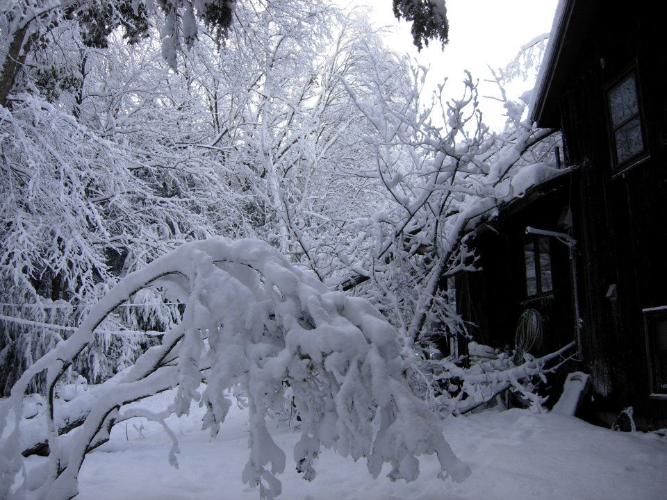

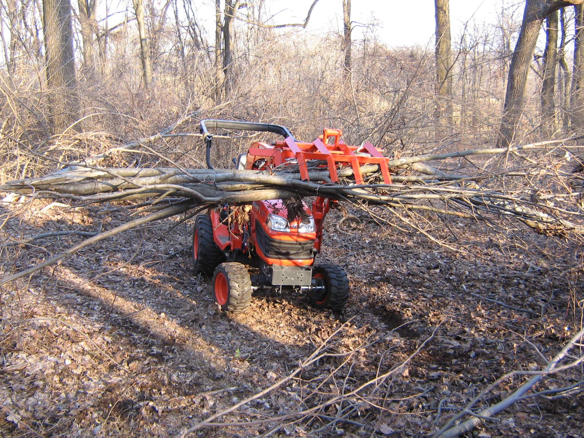

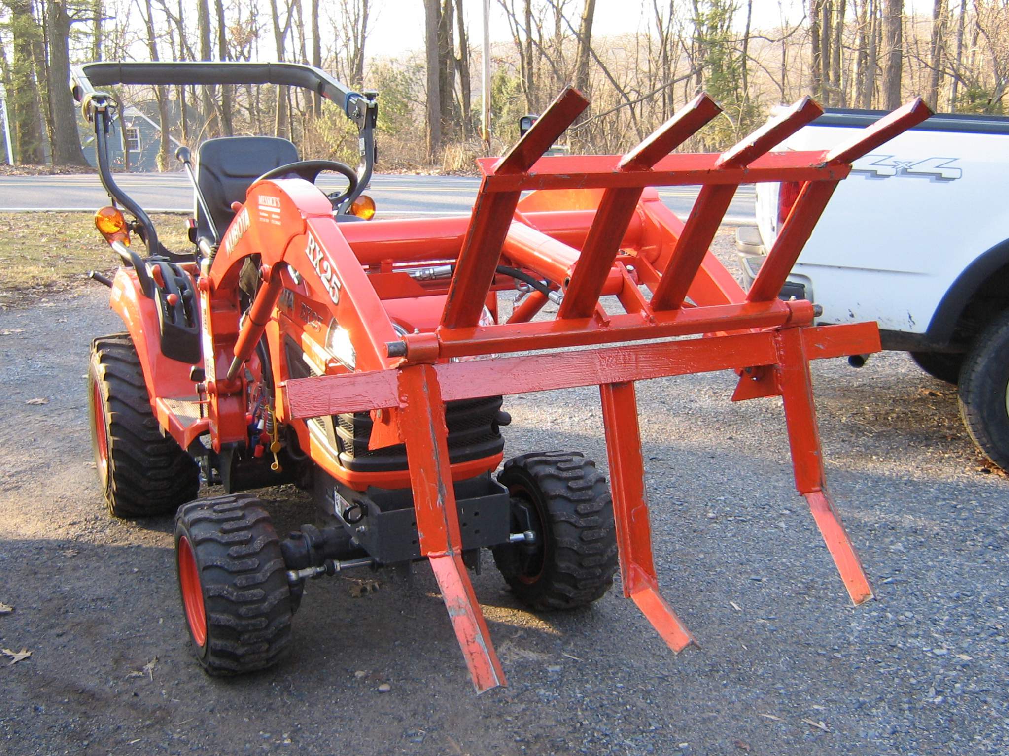

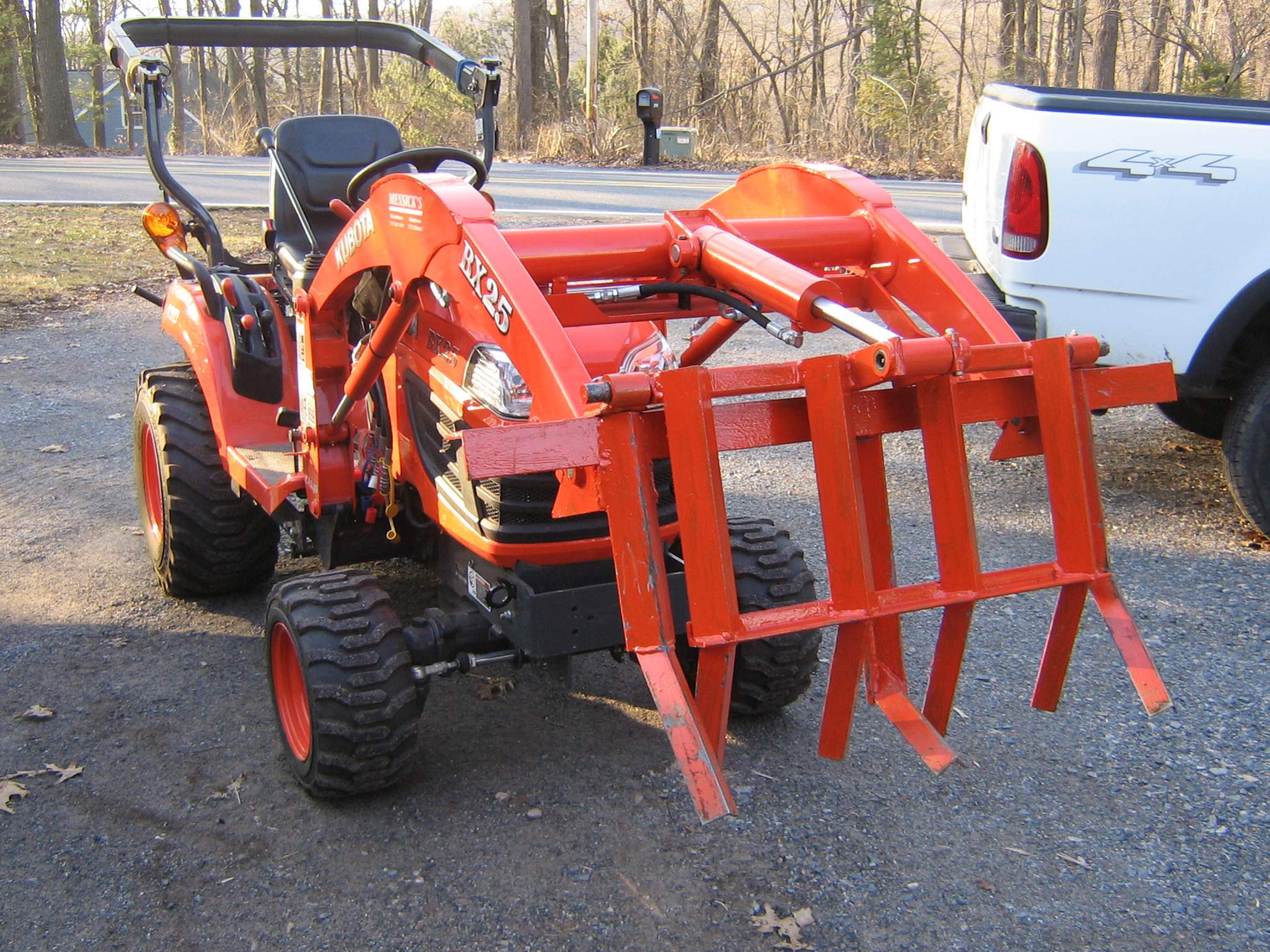

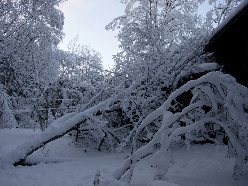

In October we had a terrible snow storm that brought down trees and branches everywhere. (We were without electricity for 7 days, 1 hr. But, who was counting? :mur:) The storm gave me the need for a grapple. Being cheap as well as just learning to work with metal, I set out to build my own. I recently took a welding class and have been welding up a storm. The only way to get better welding is to practice and there is no better practice then just building things. If I knew more about hydraulics, I would not have built the grapple the way I did. Maybe I will make another after I can get the hydraulic situation figured out. But, until then, this one will be just fine.
My real reason for posting this is to encourage anyone out there, who like me might want to try welding and metal working but just hasn't, to take a welding class and dive it. I am an accomplished woodworker, but for now I enjoy working with metal so much more. Work with wood and you can build a house, work with metal and you can build the world!!! (or a grapple) lol

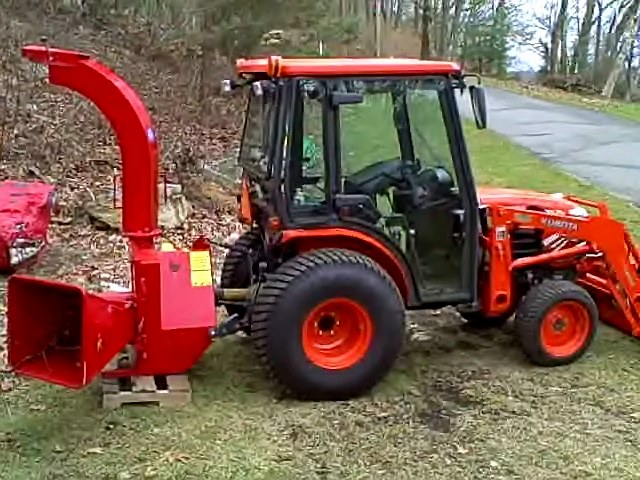

I was involved in the same snow storm that knocked all our trees down. I found this attachment on Craig's List for my B3030 to help any more big storms that knocked down trees.

I like what you have built. Seems you think outside the box. What would you change now that you have used it? What do you think it weighs? There is a lot of satisfaction in building something yourself. :thumbsup:

magicheater - When one is cheap, thinking outside the box becomes a necessity! :) If you notice on the picture, the angle iron between FEL arms is longer than it should be. I originally was going to make it wider and probably should have, but I realized that the angle iron was too light weight to support the stresses outside the arms. Even the center tine causes the angle iron to flex. I should have gone heavier. Other than that, so far I am very happy with it. Of course, it has not had much use, yet. As for weight, I am guessing it weighs around 150 lbs. I am curious, too. Next time I have it off, if I remember, I will get out the bathroom scale and weigh it.

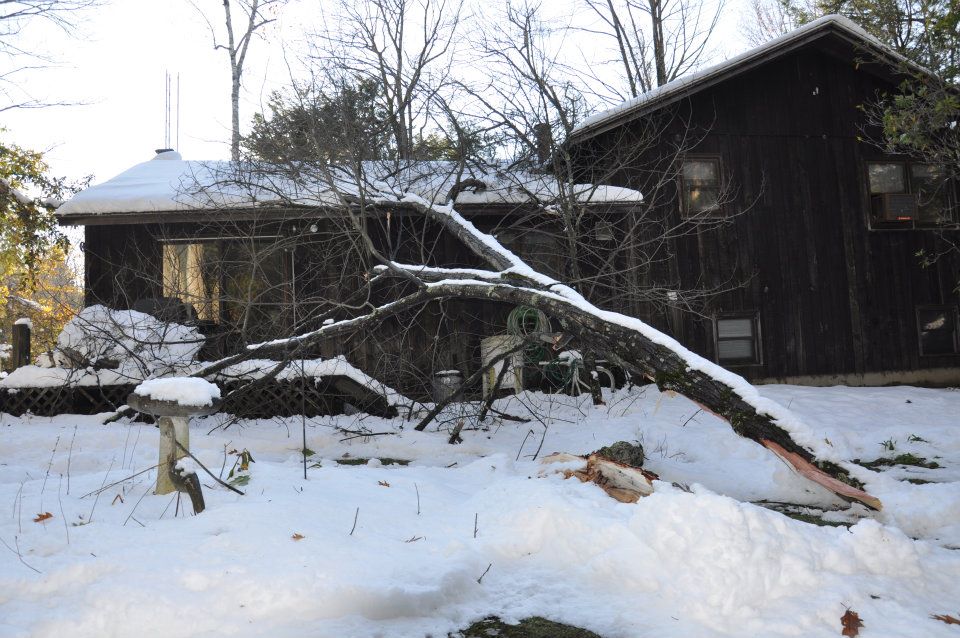

I have an 1850 and was also in the October pre-Halloween storm. We had a tree fall on the roof but were lucky. There was already a foot of dense snow on the roof. As the tree slowly broke in half about 20 feet up it sort of hinged its way onto the roof. I was actually watching it happen. I was looking out the window describing the storm to my wife and 10 year old daughter who were out of town. I was on the phone and then let out a very loud (Expletive Deleted) as it hit. The roof did bounce a bit and blew one of the recessed eye-ball lights right out of the ceiling.
The next day I was able to cut the butt of the tree off the ground. Using the BX the next day I was able to get a running start and yank the rest of the tree off the roof. I was going fast enough that the end of the tree totally cleared the side of the house as it went shooting off.

I especially like how you used the bucket curl ram for opening and closing it. Thats definitely outside the box.
In looking at how you angled the bottom teeth, it looks like you're allowing it to follow the contour of the ground somewhat so it doesn't dig in when trying to pickup debris, is this correct?
Do you have any problems w/it digging in too much?

Volfandt - I used the bucket ram only because I didn't know how to use my backhoe hydraulics to drive a cylinder on the grapple. Hopefully, someone will chime in on which lines I need to use off my BX25 BH hydraulics. Being able to tilt the grapple would be useful, but I must admit... I am not sure that ability would be worth the additional cost.
As for tooth angle. That was done to keep items in the grip of grapple. Without a large enough angle, on a test they tended to slip out. In fact, I wish I had used an even great angle. But, it can't be much more because it would make dropping the debris when the FEL is raised more difficult. Like so many things with this design, there are many tradeoffs :confused2:. The tines can definitely dig into the ground, but it isn't a problem for me because I am not using it where it matters.
