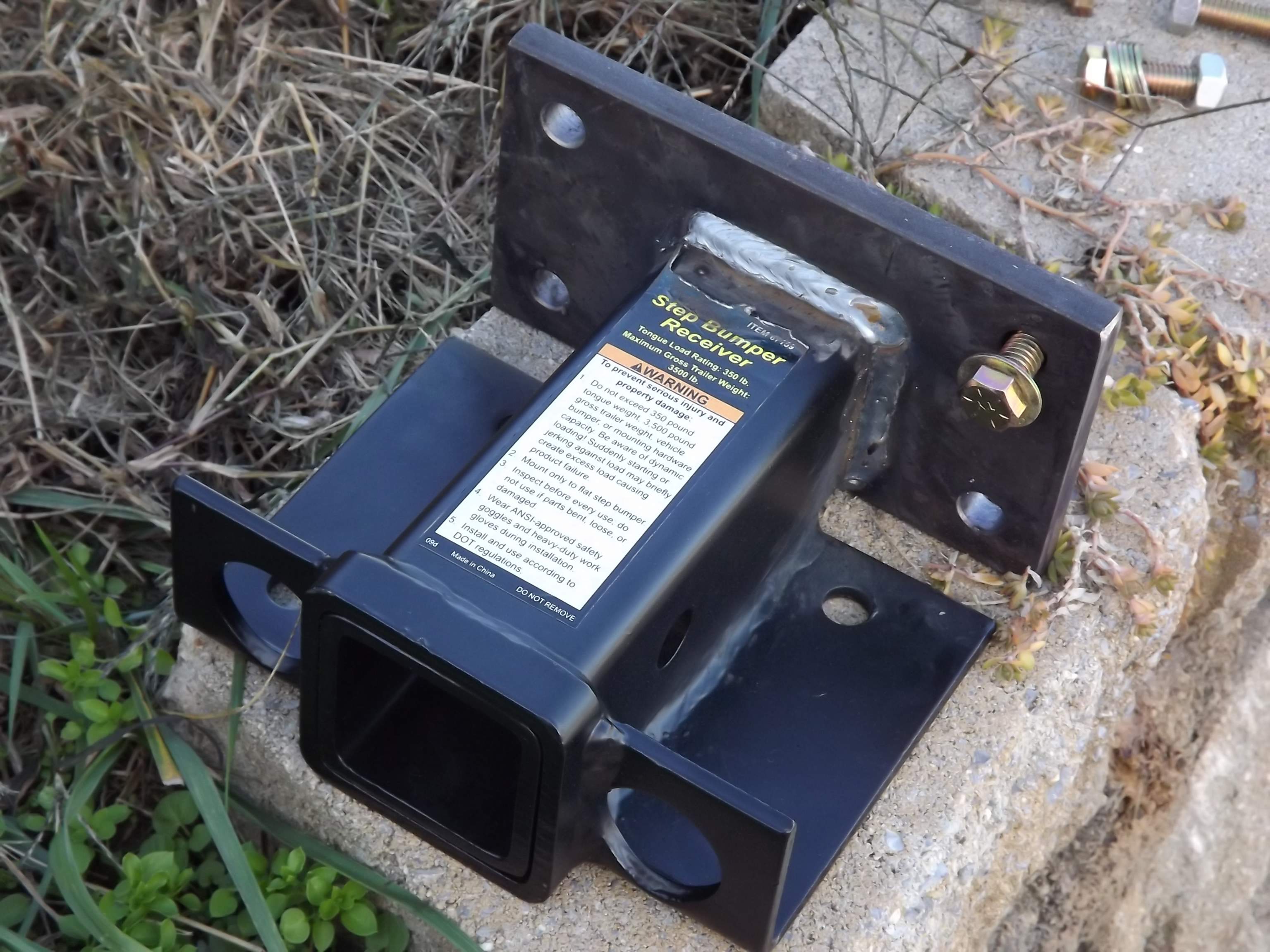

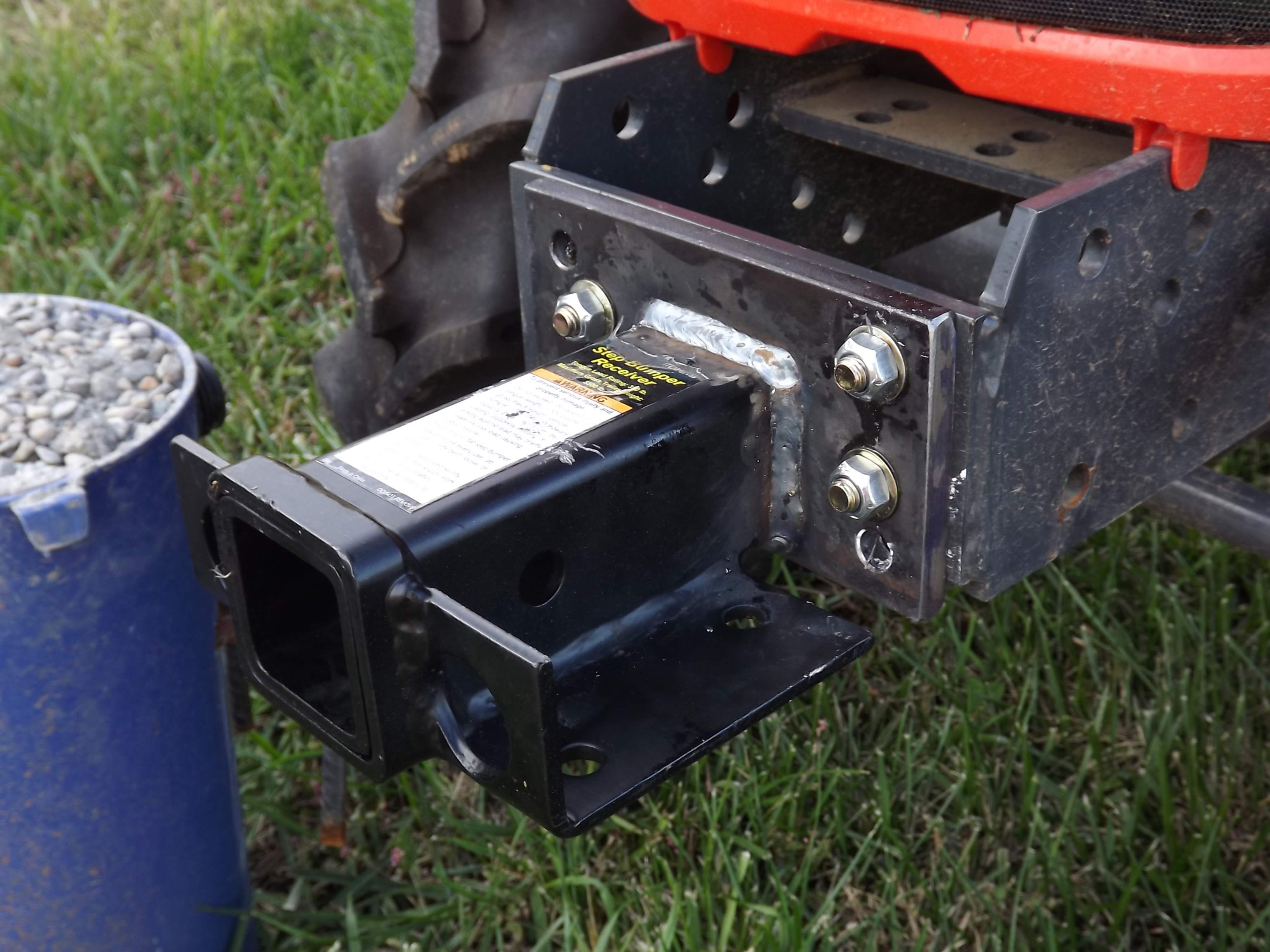

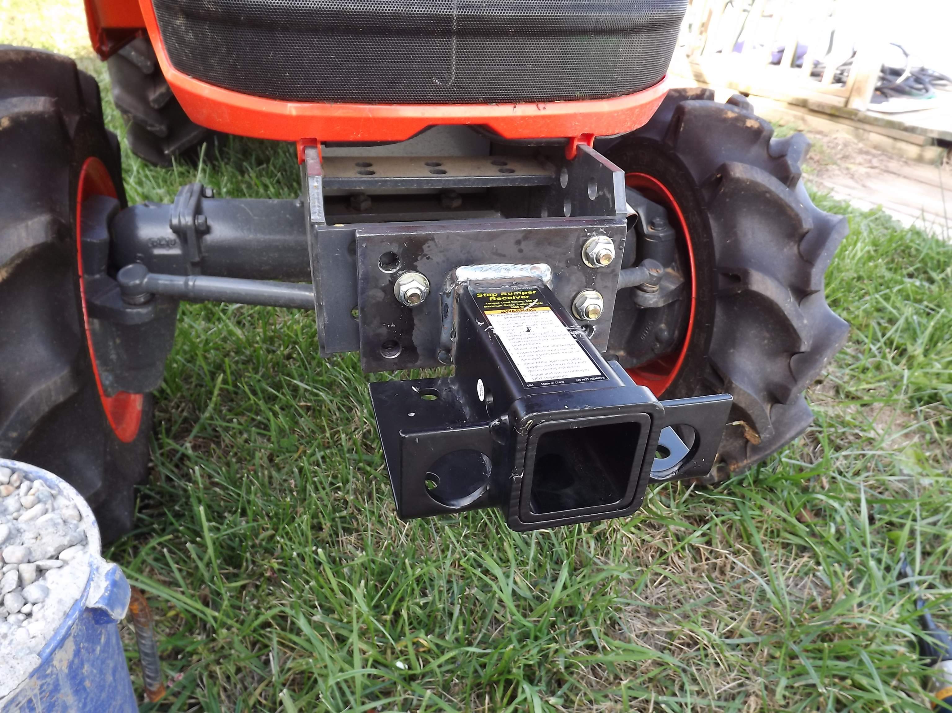

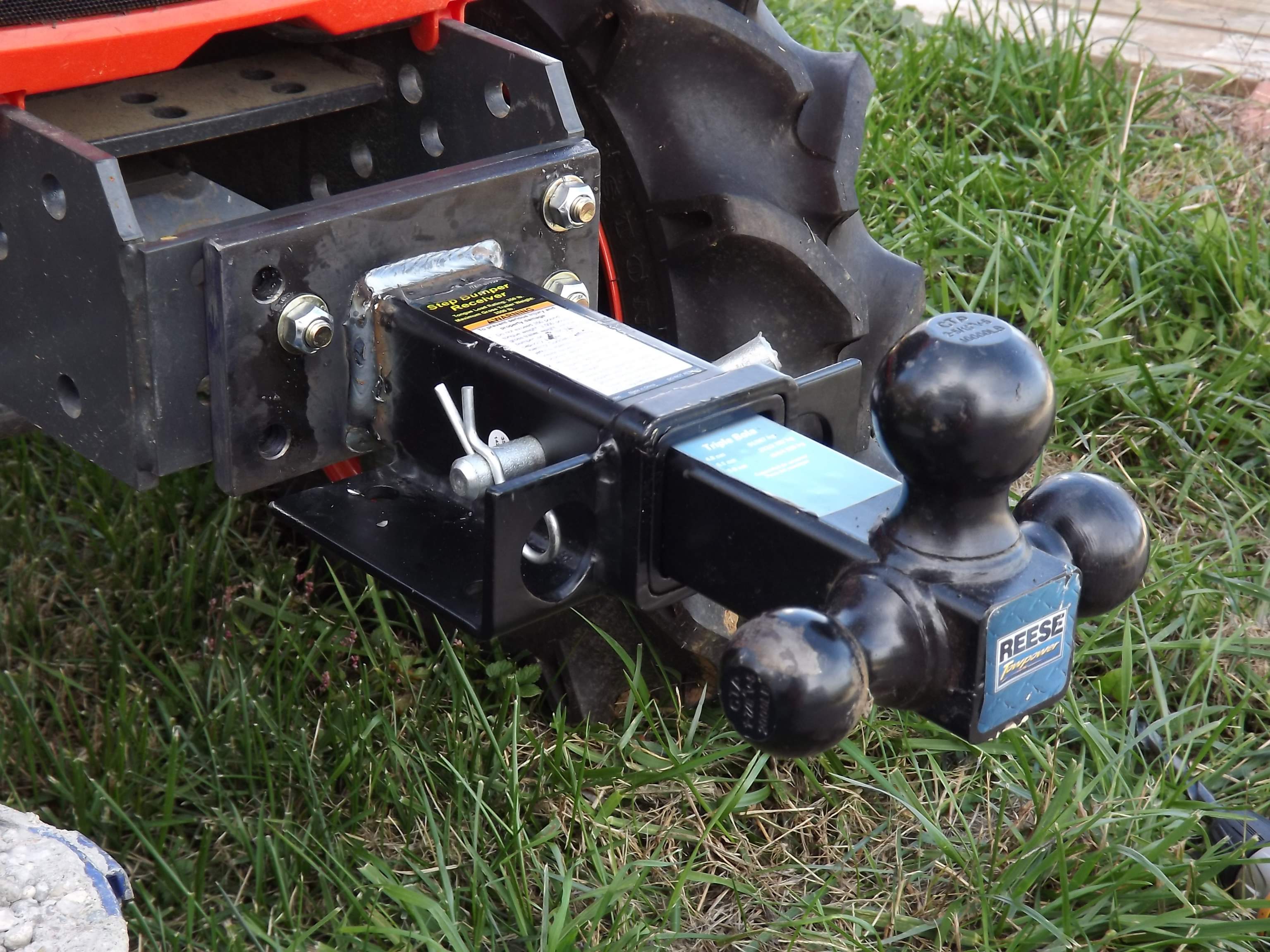

   / BX25 Front and Rear 2" Receivers #9
I used a HF step bumper hitch on the rear. It goes on and stays on out of the way of the backhoe and 3pt implements. I wouldn't really change anything other than possibly cutting the safety chain locations off to help with putting the pin in.
For the front I used a HF ATV hitch and bolted it to the inside top of the bucket where it stays. Now this I would and will go back and cut the safety hook off as its not needed and probably weld it to the bucket as it moves around the single bolt. Also since I am probably going to weld it in, I will modify it so that it comes out of the bucket level when the bucket is on the ground instead of following the top angle of the bucket. Member bx24 has done this with a spacer between the bucket and the top of his hitch. pictures in this thread (http://www.tractorbynet.com/forums/build-yourself/244534-bx24-quick-attach-front-end.html)

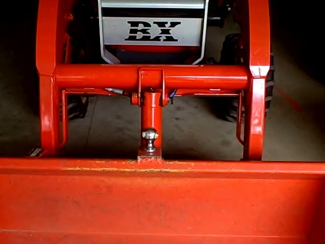

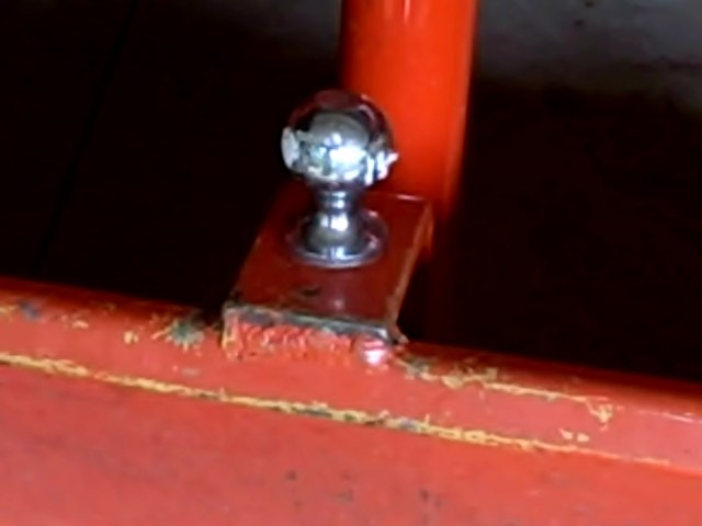

   / BX25 Front and Rear 2" Receivers #10
I used these hitches for the front and rear of my BX25. They are light duty, however, the nice thing is that you can bring the ball to the trailer.
