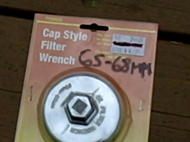

What a pain is the ars the oil filter is to remove, I put in Rotella synthethic oil, and the low idle is as smooth as a kitten purring, instantly. What a difference, also checked the front axle, and had to add a quart of udt, no leaks and it was off the stick completly, where did it go? Tomorrow I am changing the hyd filter and just adding makeup fluid, for the filter and fluid loss while cleaning the hst screen.

Get one of those oil filter wrenches that have the 3 jaws and fit a 3/8 drive, goes right in the small hole and the filter comes right out. You can tighten by hand through the shroud hole. I know the manual says remove the shroud; but, no need to until you change the fuel filter under there. Maybe a small monkey could get their hands in there w/o but I can't. I am moving it to undernerth next to the fuel booster pump.

Here's what I use on my BX25. Put it on the end of a rachet wrench extension; it gets right in there.
