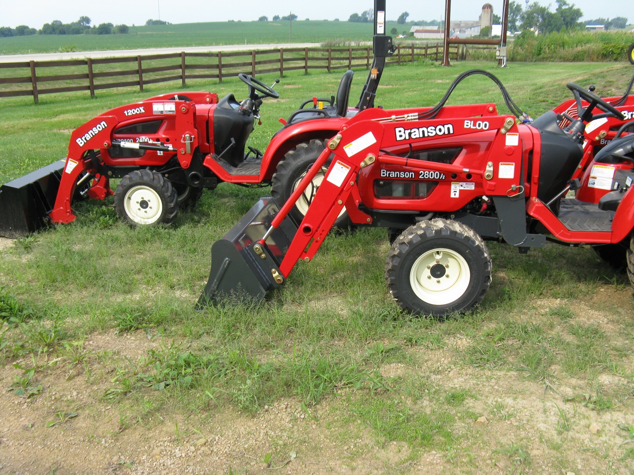

Another possibility is to change the lift angle of the main cylinders. Lowering the rear of the lift cylinders will provide increased lift capacity but decrease lift height. I believe there is a current thread about a M7040 that comes from the factory with this option.
You have to do some geometry to calculate the load capacity change by moving the pivot point 2" or what ever distance you would choose.
Picture of the two Bransons shows this. Tractors are the same frame size but look at the distance between the rear mast pivot and the rear cylinder mount.
