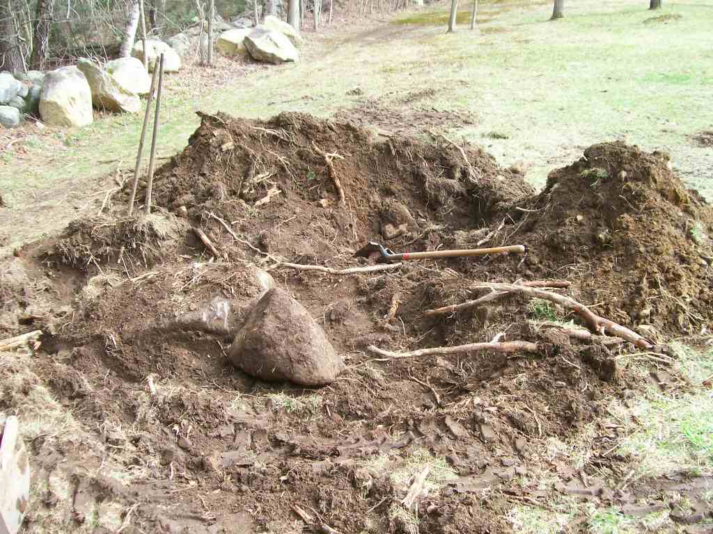

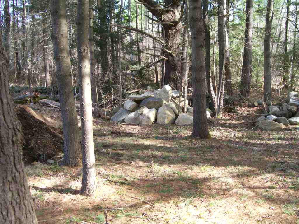

Many of us are faced with the same choices, and between the two tractors you are looking at, the choice can be difficult. Here is a link to a large lawn project that Kiethinspace completed with his BX, and it sure looks great!
http://www.tractorbynet.com/forums/kubota-owning-operating/120304-update-massive-lawn-project.html
Here are some pictures of rocks that I dug out, and moved around with my BX22. The rocks in the pile are about as large as you can move around with that size tractor using the loader. The rocks pushed against the stone wall could not be lifted, and had to be rolled /pushed using the loader. The smaller rock in the hole is easy for a BX, the large one I didn't even try! :) The loader capacity of the B2320 isn't much different, but the backhoe is somewhat stronger, and has a bit more reach, and swing. The big advantage of the B is that while the weight of the tractor isn't much different, the tires are larger, and would hold more fluid for weight. The bigger tires also put more of that HP to the ground, and that makes a difference when pulling a box blade, etc. If you buy that rougher ground, you will want the clearance of the B2320 I think. I feel your pain since I am still debating the two myself.
