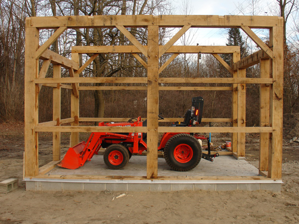

I'm building a 12x16 with 8" walls giving me a floor space length of a little over 14'5" and there isn't enough room for a backhoe (I don't own one so I'm not worried about it). Here is a pic with my 7610 inside the frame maybe this will help with scale. I would think you would want to go at least 18'.
Regards,
Kevin

If you have the funds and room you may want to build your shed 6'or 8' larger both ways,for in years to come there be a good chance adding goodies inside,also its not much fun working on cramp floor space.

That is one AWESOME framework job :eek: You plan on using that frame to hoist the tractor too????
