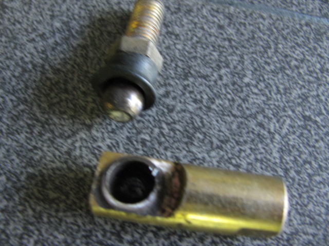

The diagnosis was correct, the back end of the rod was detached. Part 130 was broken in two, fortunately the dealer had it in stock. I needed to remove the hydraulic filter to get to the broken part then it was straightforward.
Thanks
Tom
