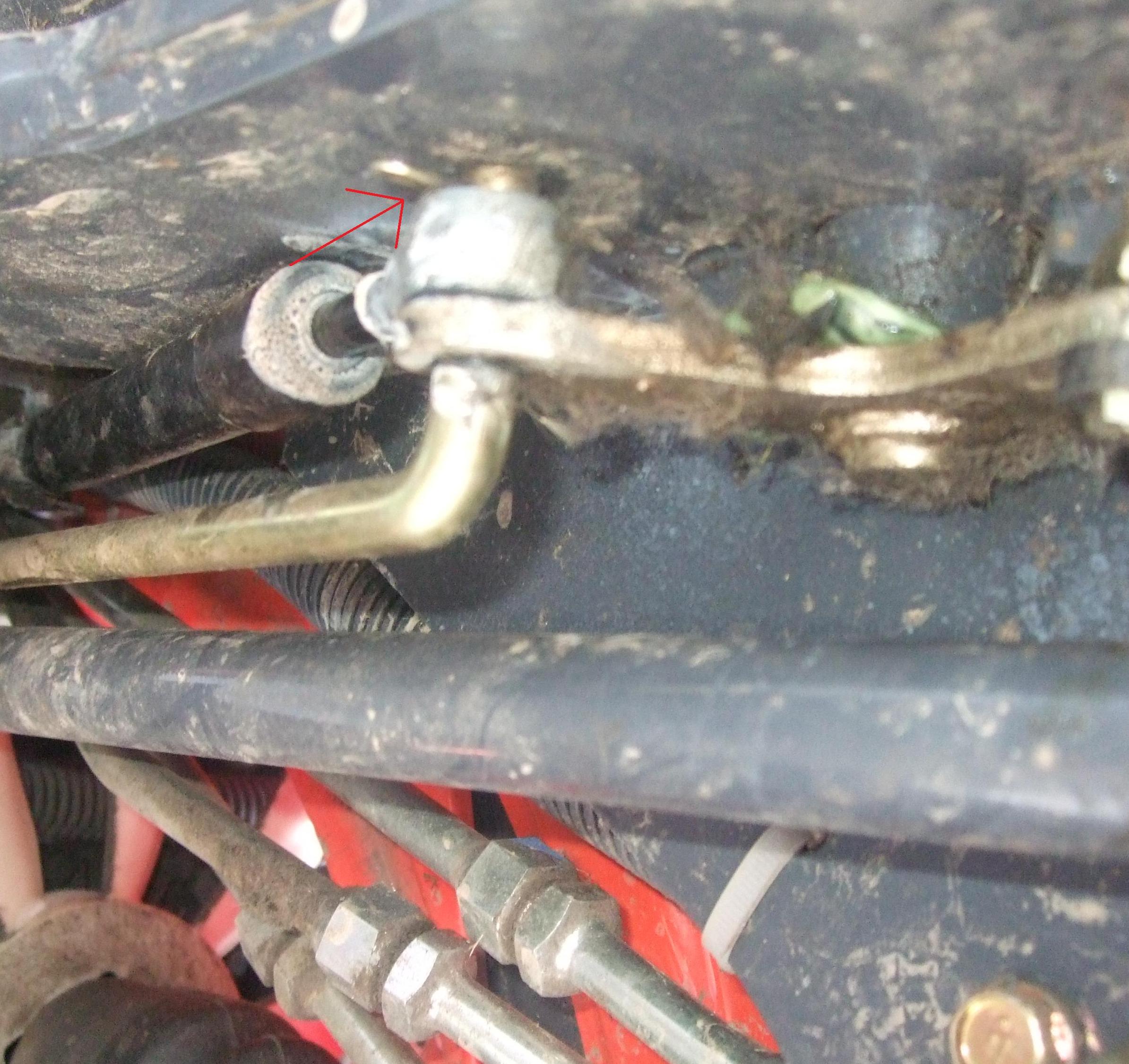

Here is what my BX25 looks like.
My problem is I found one of those clips in the street after my dealer dropped off my new tractor, and I have to figure out where it came from.

   / BX24 Seat-- Spring Loaded Lever Came Apart #3
Jeff -that clip looks like it belongs underneath the tractor on the dampener for the HST tredle. There are two clips , one on each end.

Hello Radioman
I just went through the parts list for all of the "RUE RING COTTER" clips as they are called, and went over the tractor and accounted for all of them as best as I can tell.
Hopefully when my dealer delivered my tractor, this slid off of his flat bed left over from another tractor.
I count the following in the parts list used in the areas listed, and have accounted for them.
4 - speed control pedal ( 1- K1211-91130, 3- K1211-91120 )
1 - differential lock pedal ( K1211-91120 )
1 - brake pedal ( K1211-91130 )
1 - mower link RH ( K1211-91110 )
1 - mower link LH ( K1211-91110 )
1 - link rear lift LH ( K1211-91140 )
3 - seat support ( K1211-91130 )
Did I miss any?
Thanks
Jeff
   / BX24 Seat-- Spring Loaded Lever Came Apart #5
yeah- the damper clips, there two of them. have you accounted for them too yet ?
   / BX24 Seat-- Spring Loaded Lever Came Apart #6
Yes they are 2 of the 4 in the speed control pedal group.
