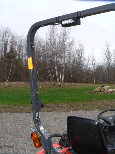

On my BX23 and on my B3030 I put my lights just below the fold point on my ROPS, they are about at my eye level, it is perfect. Try a mock up by clamping a light on your rops at different levels and see what you like best. Take a look at the attached photo.

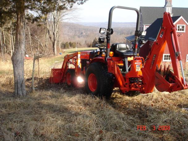

BX24d,
I don't know what your dealer is talking about. I had my dealer install the optional rear work light which comes in a kit when I bought my BX23. The supplied wire is simply zip tied and the light is mounted above the hinge of the rops. Recently, I purchased two more of these lits and installed them on the top bar of the rops facing foward. I tied into the same power line which is fused. My only complaint is that the original light was orange and the new ones came in black. My dealer said they must have switched vendors. The part number is the same. I painted them with spray paint and it was great this winter both foward with the plow blade and backwards with the rear blade at night. Oh yeah, I did not wire in a switch and use the switches on the lights..I can choose whice ones I want on and it is no problem.

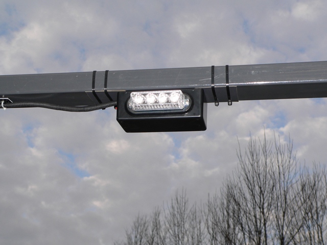

BX24D,
Here's what I did to mount a LED flasher to the ROPS. The flasher is mounted in a Radio Shack project box with a waterproof toggle switch on the side to turn it on and off. The wires are in flex wire loom and are connected to the aux power leads at the back of the tractor. It has worked fine for me, and there hasn't been any issue with the wires getting snagged by branches.(2 years and counting)
