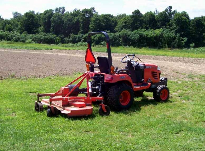

Perhaps the trick is to match the rear finish mower closely with the BX. For example, both the Landpride 48", and Woods 54" seem very well matched, and small enough to move around easily. The attached photo is a Woods 54" on a BX2350. Front weights are used for balance when transporting. The owner of this BX likes it very well, and needed the rear discharge to keep grass clippings off from his small Christmas trees.
