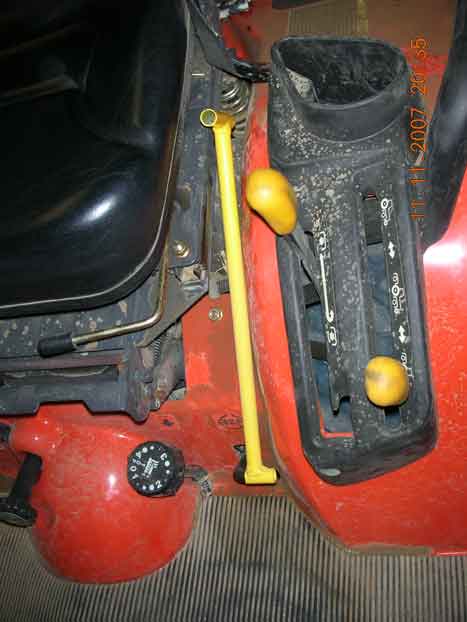

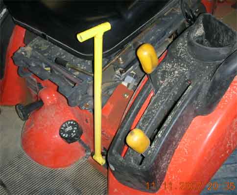

This simple modification allows me to use the differential lock by hand, does not get in the way of anything, and I no longer bump my head on the steering wheel when bending over to engage the differential lock.
For those of you that don't know, my left leg is MIA. :rolleyes:
PS. The dirt comes from a blown hydraulic line and 30 hours of windy dirt work.

That is a great solution!
You could probably rig up something very similar for Emergency brake engaging foot lever, as well.

Nice idea Carsce!!
