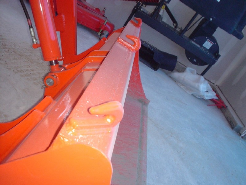

Well Fellas, After window shopping for the last year I finally pulled the trigger today on a new BX24 with a 60" mmm. You guys have definitely helped me get to this point. I was actually ready to get a B7610 with a loader and rear blade but reconsidered to the BX. I won't see it till mid week so like many of you all I may have a couple sleepless nights. They are going to put hooks on the loader but with the ridge across the top it makes more sense to put 3 across the top inside. Any experience or suggestions with this model bucket and hooks. Are they a good idea at all?

I 've had my BX24 for a couple of weeks now and love it so far. I have 15 hrs on it already. I had a single hook mounted to the top center of the FL. The dealer welded a 48" piece of channel across the top and then mounted the hook. They even painted it all up. Looks very strong and looks great. I heard mounting the hooks on the corners of the FL on a small tractor like a BX was not a good idea because so many folks tip or roll these small tractors while using them.

<font color="blue"> They are going to put hooks on the loader but with the ridge across the top it makes more sense to put 3 across the top inside. </font>
I can't imagine wanting my hooks on the inside. The reason is that with them on the top, the chain hooks in them then hangs down over the lip of the bucket, which keeps the chain in the hooks. My guess is that if the hooks were on the inside of the bucket, the chain would fall out while you were trying to hook it to/around something.
Like another poster in this thread mentioned, welding a piece of angle/channel across the top lip of the bucket may be the best solution. For two reasons. The most important of which is that it makes the top lip VERY strong. If you would have a center hook without a strong upper lip, you may bend the upper lip when you try to pick something up with the center hook. (second reason is chain may not stay in the hooks). A third reason is that it provides a good surface to weld your hooks to.

You are Right Henro. The more I thought about it the more putting them inside the bucket is not a smart plan. I looked at some threads pertaining to this subject but I don't think there was a lot that pertained to the BX24 bucket. One photo I saw had 3 on top toward the back which looked ok. I don't think my dealer will want to add channel across the top so maybe I should tell him not to worry and do it myself. If anyone has a picture of hooks on the LA240 FEL I'd appreciate it.

here is a photo of the hooks I put on my BX23, the angle welded across the top not only adds rigidity but it gives the hooks more height which makes them easier to use and it is easier mounting them
I use the center hook alone 99.99% of the time but I guess the other two are good to have, note the angle of the outside hooks
I also welded one on the BH bucket, this has been extremely handy

Thank you for the PICs AMR.
very helpful
