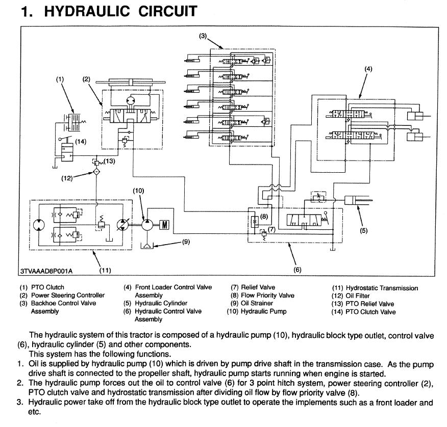

The manual for my BX24 seems to say take off backhoe when using MMM, does it really mean to remove the backhoe or just disconnect the hydraulic lines?

I've mowed a small area with the BH installed on my BX 24. There was no interference and the mower worked fine. The manual says the BH hydraulic valve can be damaged. My guess is that in some circumstances the use of the 3pt control valve may create a high pressure situation in the return-to-tank line. Most hydraulic valves have a pressure rating for the "P" or pressure port of say 2500 psi and a pressure rating for the "T" or return to tank line of only 500 psi or so. A high pressure spike on this line could conceivably damage the valve. The 3pt system and the BH may share some of the return to tank hydraulic circuit.
With the BH installed you can't use anything else on the 3 pt so it probably is only a concern with the mmm.
Mechanically, I don't see any problem if the hydraulic lines were unhooked from the BH. It is clumsy to mow with the thing on though.

There must be a huge difference in the BH spool valve between the earlier BX TLB's and the BX24 in that it needs to be bypassed inorder to run the mid pto. (presumably).
Since the pto(s) are hydraulically accuated the valve may cause too much of a restriction. Just guessing.
Actually, the 3PH, pto, FEL & BH are all on one series circuit. So pressure must flow through all the spools. That is why the BH connections have to be looped back inorder to "close" the circuit when the BH is dismounted. The FEL spool does this automatically. There is a priority valve that splits the hydraulic pressure for the PS circuit which kinda makes it a series/parallel circuit w/the rest of the hydraulic system. Kubota would rather the implement controls fail than the steering :D

On the BX's the MMM's lift arms are connected to the right hand upper 3PH lift arm via an adjustable lift link. Unlike the big fella's, all the linkages for the MMM lift stays put when the MMM is dismounted and doesn't interfere with the 3PH's operation. The MMM's lift links can be locked in the up position and this doesn't interfere w/the 3PH operation either.
I was alittle off on my hydraulic system description, the attachment is the WSM's explaination.
