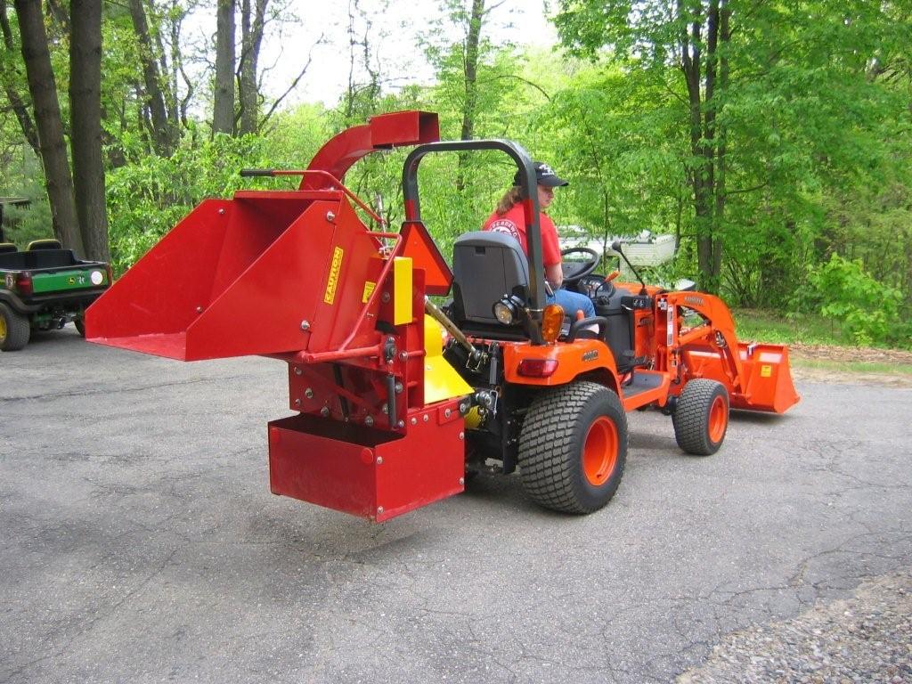

Thanks for the replies. I wouldn稚 be chipping anything in the 6 range, most of the stuff I would be chipping would be approximately 4 or less. Is there anyone with first hand knowledge of the JINMA 6 on a BX24 chipping 4 branches.

I run a 4inch Patu Chipper on my BX 24 handles that with no problems, I know other people running 4inch models on their BX series tractors. Not sure on the 6 inch

Can a BX24 power a JINMA 6 wood chipper? Can the 3PH handle an 800 pound attachment?
Yes, It will work very good. I had this hooked to my BX2230 with simular power rating to the BX24. The BX24 will lift the chipper better and higher, as the 3pt was improved. The pictures are of the Ginma chipper mounted on my newer BX2660 (being driven by my wife).
