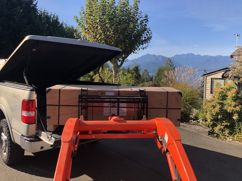

Here is me unloading my new 450lb wood lathe, maybe close to 500lb including the crate. Love my QA and adjustable forks. Never dreamed I would use my forks so much and probably wouldn't if I didn't splurge for Jery's QA and forks.
