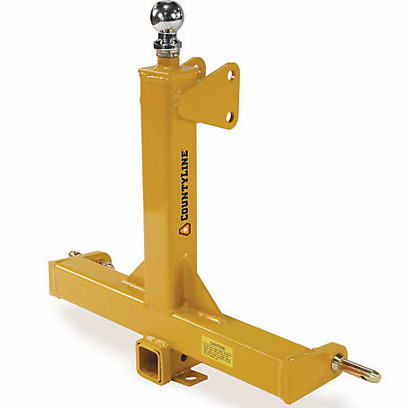

County Line Trailer Mover at Tractor Supply Co.

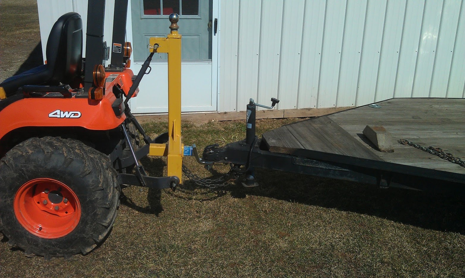

I got one... best thing I ever bought.
Here it is on my BX2200:
cGU026RMNTYXwfr6uDSPCLs-fCweqkNgjCuoKXL5nbyacCQvNzuwpmhKRyyTnxw_gypU_sdS5Z-N9XVDegKw1Au9FpSJwCe_.jpg
Yeah, I know, before the safety police get me... I know... I didn't have my safety chains cris-crossed, as I was only moving it around the barn.

I used a BX25D to move a number of trailers around at my camp and home for 9 years. One of the trailers was a 25 foot Haulmark enclosed deck over - close to 3000 lbs empty. I used a receiver hitch welded onto my bucket and it worked well. BUT - a couple of cautions from my experience. With the backhoe on, I could manage the load well enough by going very slow and avoiding sidehills etc. With the backhoe off, the trailer weight on the bucket would easily lift the rear wheels off the ground. I had a couple of bad scares on slight side hills. Make sure that you have plenty of counterweight on the rear of your tractor.
I recently upgraded to a B2650 and made a SSQA receiver plate for it. It moves the trailer quite a bit better with only a landscape rake on the rear.
This is the BX hitch.
   / bx2380 moving a 24' Haulmark trailerl around with a front skid steer receiver hitch #10
I use one just like that for a 21ft Pequea deck over that weighs a bit over 3000lbs by itself. Using a B2150 Kubota which moves it jusrt fine. A less-than-obvious problem is using the pickup truck to park the trailer in an old shed (which has an uphill hump approach) the pickup hitch is at such an angle that it is caught in the trailer cup and you can't release the darn thing. This 3pt device works fine. HOWEVER you will find many Koboutas (certainly the BX2200) are too narrow to accept the std "T" device. Someone makes a narrow version for that reason. The one I bought was from a guy who did his own welding and cut down the width himself. You can see in this picture where it was made more narrow.

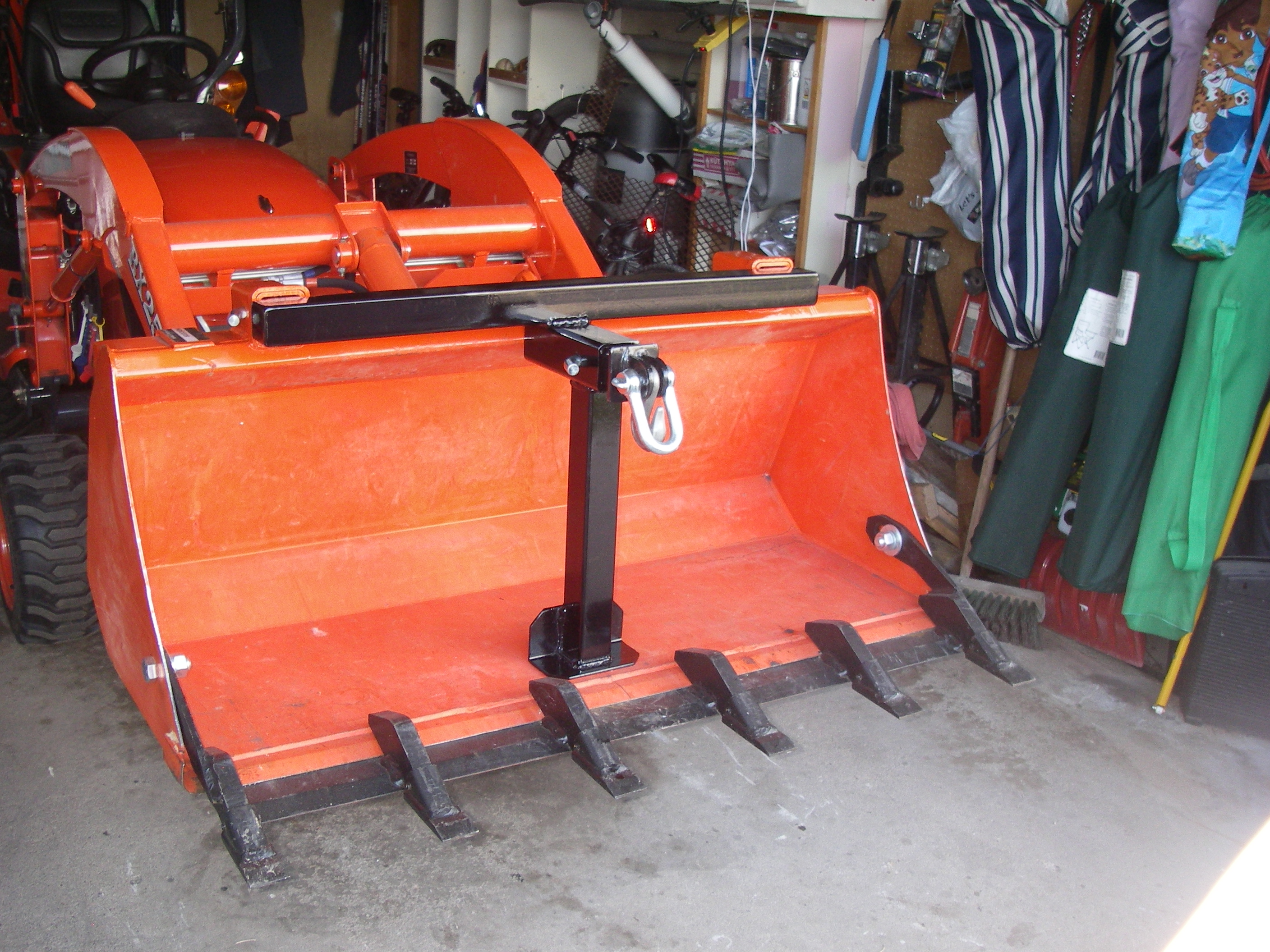

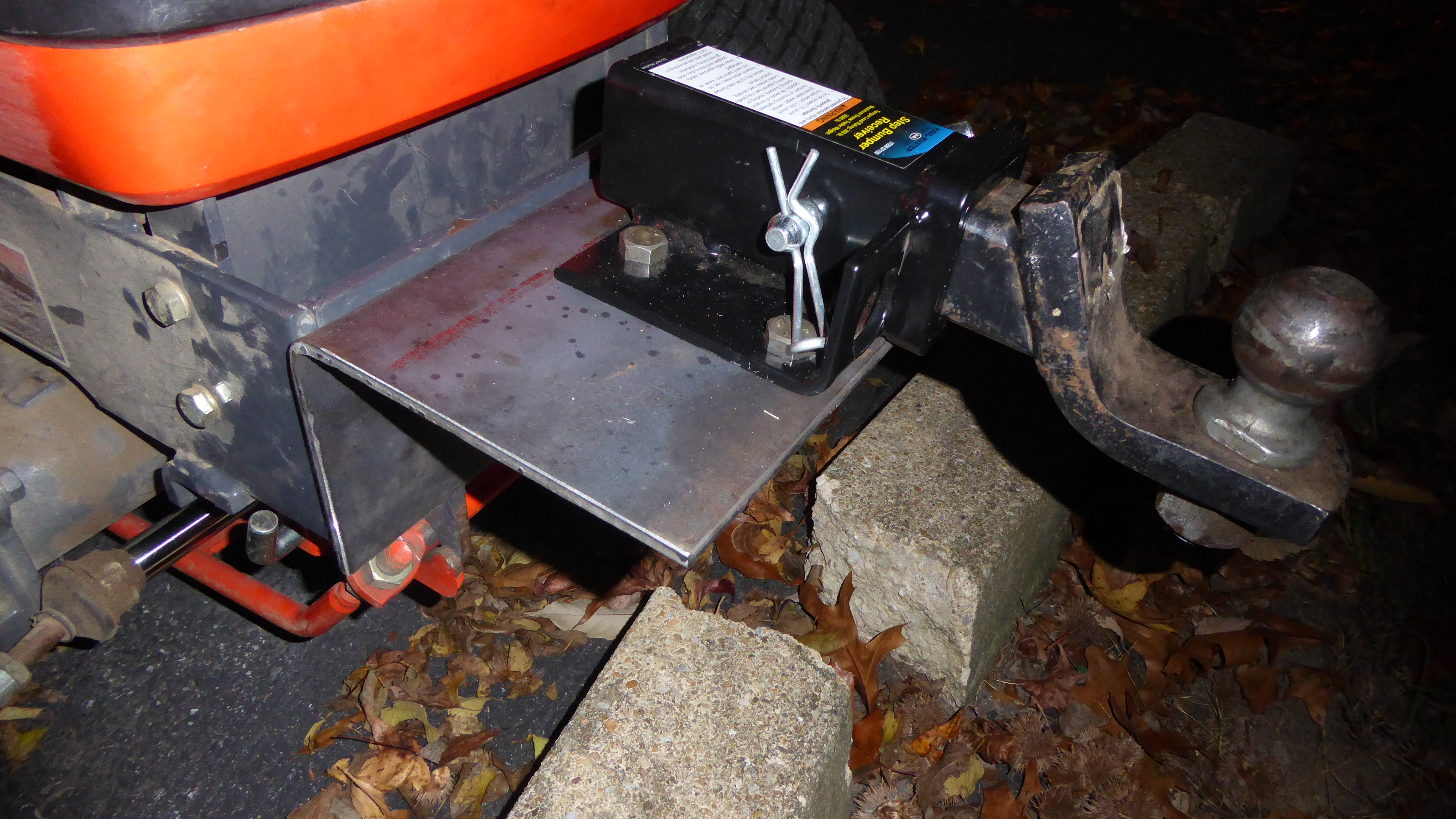

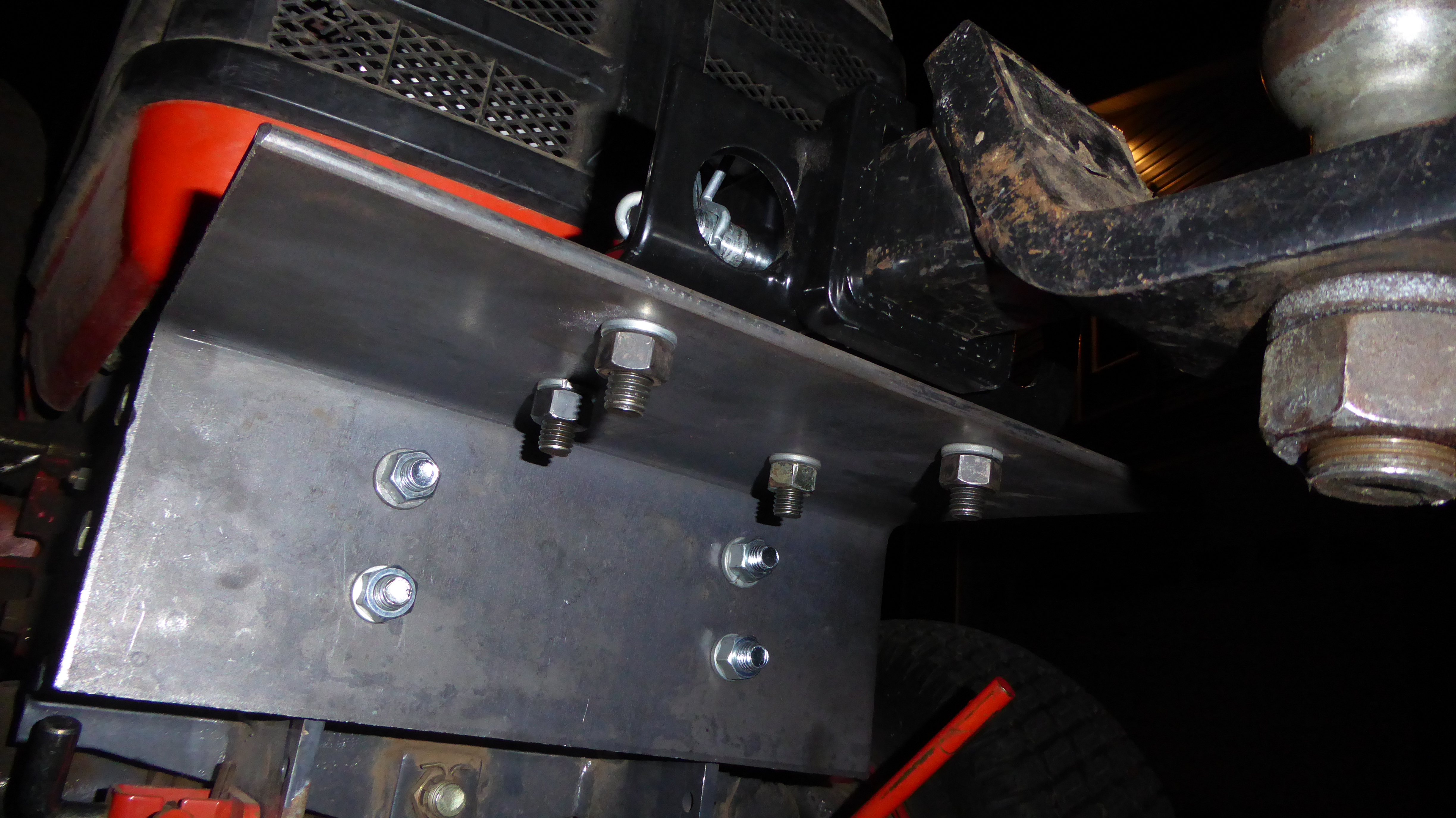

Your BX2380 is going to be a little light in the loafers for moving a 24 Haulmark EXCEPT on flat surfaces, pavement, etc. As someone else said, watch out for tongue weight. The "empty trailer" tongue weight will be no problem for you (using the loader or front of the tractor) but don't try to do it with the trailer loaded (which may be obvious.)
The skid-steer adapter may be very attractive to you for other reasons (for most of those 'other reasons' the 2380 is too small...) but here is another option:
For my BX2200 I had a large "angle iron"piece made out of 5/16" steel plate, bolted that to the front of the BX and bolted a "step bumper" receiver to it.
This installation is grossly simple, clears the FEL fine (with or without the ball hitch inserted), and moves trailers around with ease.
One advantage of this over using the loader is that the trailer has less leverage over your tractor and far less tendency to tip the tractor or affect it in any regard. (I did the same thing drilling holes in the bucket and using the "step bumper receiver" bolted temporarily to the bucket.)
This permanent receiver hitch arrangement works better for me.
