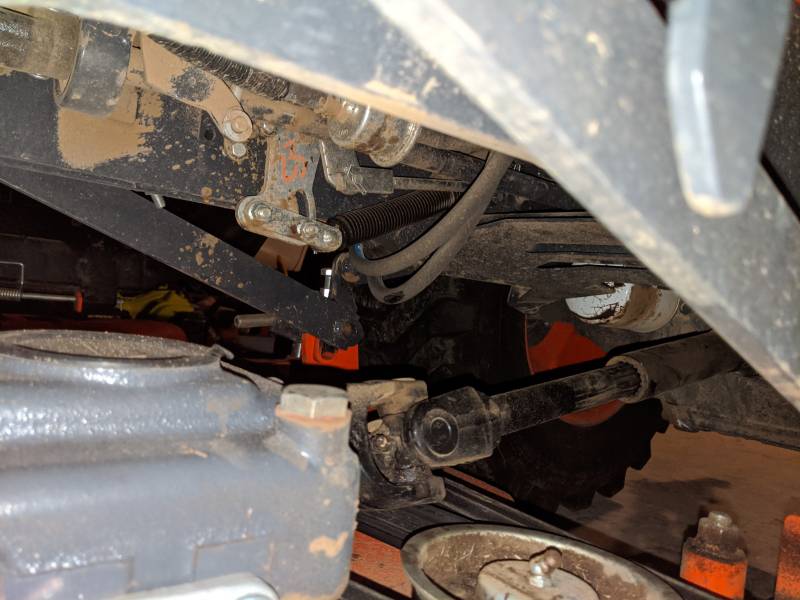

Just like the title says, my mower belt has rubbed a spot on these 2 hoses. Obviously, it would only happen when I'm mowing with the deck all the way up, which is rare.
But, it does happen.
I bought this new last year. My bx1800 that I had for almost 18 years never had this issue.
I'm assuming I can just zip tie them a little tighter, but I was messing with it this afternoon, and they don't have much play, they're pretty tight.
Is this just a goof from the factory?
Anyone else have to deal with this?
What's the best way to remedy this?

I had a similar situation on an older b. If it were me I’d reroute them out of the way. Are they for a third function valve?

On my bx2200 the lines run under the engine in metal tubing and don't come anywhere close to the mower deck.
I do have a 3rd function that the dealer added. Makes sense that's what they are and not from the factory.
   / Bx2380 hydraulic hose rubbing mmm belt #6
My 2380 does not have a 3rd function (or loader) and I don’t have those lines. From what I remember there is not a lot of options in that area for rerouting, is it still under warranty? Might talk to the dealer and see if they’ll make it right.
