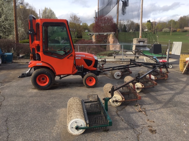

Im taking ownership of a kubota bx2380 Monday or Tuesday dealer is putting together. I am using the tractor to pick golf balls at a golf driving range, my Mitsubishi mt372d is on its last leg that I currently use. My question is has anyone put a curtis cab bx80 on themselves? Dealer cant do it for a couple of weeks. I actually went to Curtis today and picked up the cab thru the dealer because they wont sell to the cosumer. I have put a curtis cab on my new holland tc33 and a curtis universal cab on my Mitsubishi. If anyone has is there any tricks to it? How long did it take you? Did you do it yourself or with help? How do you like the cab, any info would be great, thanks Mark

Installed Curtis Cab yesterday with no hick ups, it took me a little over 4 hours. I have done a cab on a Mitsubishi and a New Holland before. I had help the last 2 hours putting the roof on and the doors on. The curtis manual was good, but pictures could be blown up a little more. When you first get it and open the box you see what seemed to be a million parts, I was a little overwhelmed . Followed the instructions and it went good. All the parts are nicely package and labeled. The only things was the spacer brackets for the front window were with the heater parts bag, couldnt find them at first and was a little annoying. My advice if you have the room take everything out of the box, and lay the parts spread out on the ground and dont tighten the bolts as you go because there will be some adjustments to be done to the cab. Good luck to the next person. kubota bx2380 cab.JPG
That is a golf ball picker on the front of the tractor for anyone wondering.
