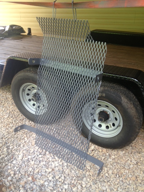

I like the idea of just using expanded metal for the fan protection. Any chance that you have a picture that you could share of how you did yours?

Chuck here is the skid plate I threw together.
I was pressed for both time and money otherwise I would likely purchased something from Bxpanded or Brotek. Both outfits make quality products for appropriate prices. That being said I'm pretty happy with the skid plate as a first metal fabricating project. I needed it on short notice to do a bit of work at my wife's family's vacation home. Some kids kicked the tack room door in and we figured a bit of property maintenance might deter future shenanigans.
Anyways if I were to do it again I would make the front arms so that they hooked to bolts that I would permanently mount on the bx's frame. Also I would have made the skid plate just a touch deeper in depth (~1/4"-1/2") in order to accomadate the linkage for the forward/reverse pedal.
*I've also thought about going with wheel spacers like Dragoneggs mentioned. I just haven't gotten around to it as of yet.
