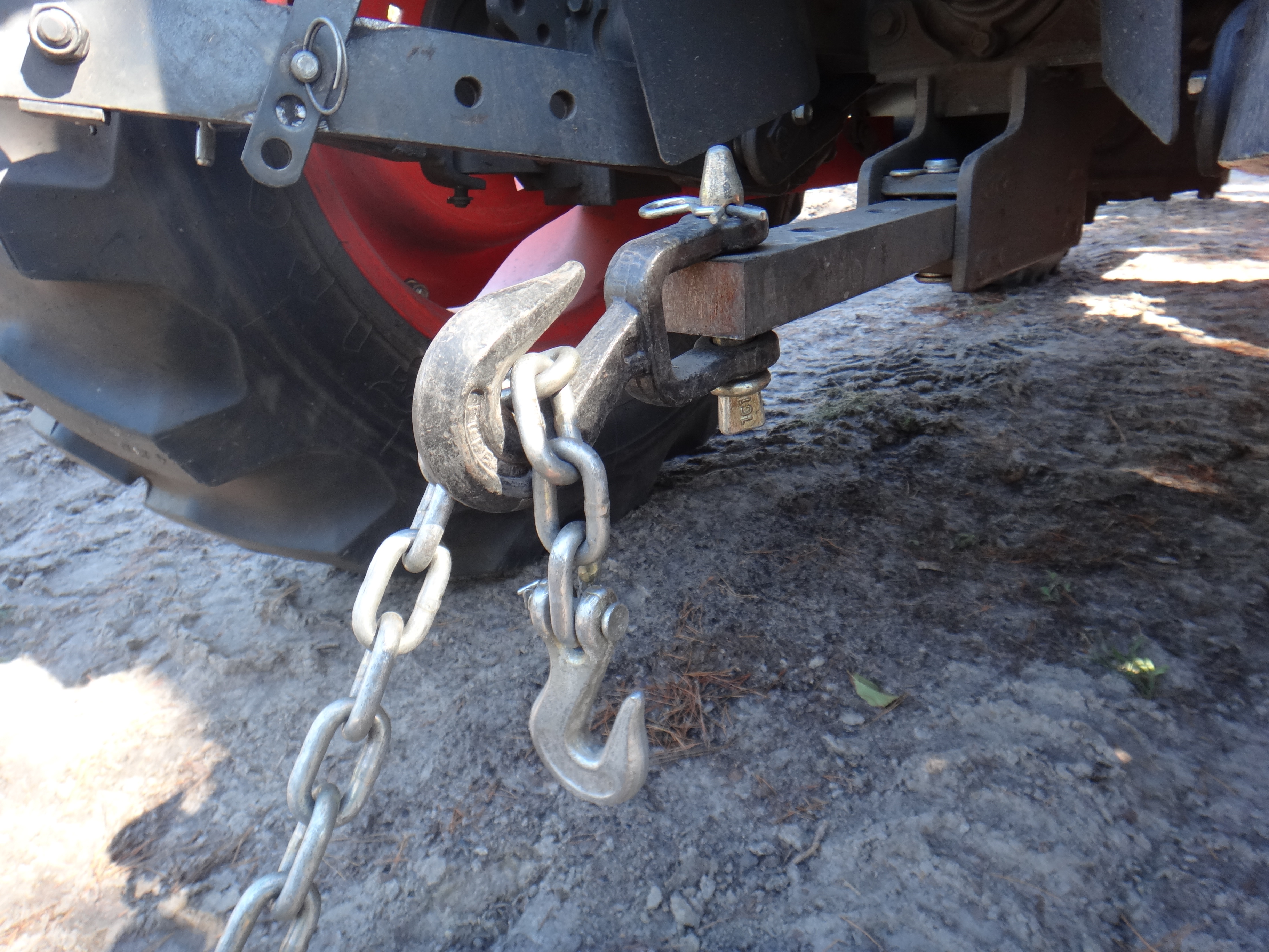

I've also got about 60' of boxwood bushes I hope to remove with this: BrushGrubber.
Loosen roots with FEL bucket.
Do NOT pull from the FEL; you will wreck it.
Pull only from rear/center drawbar. Wait for moist soil.
No jerking!
No jerking!
I'm starting from 0.
I was fully expecting to pull with the FEL.
No jerking, and I can wet the soil.
Looking at a 1-2yr project, so plenty of time to figure out how to do it correctly.
