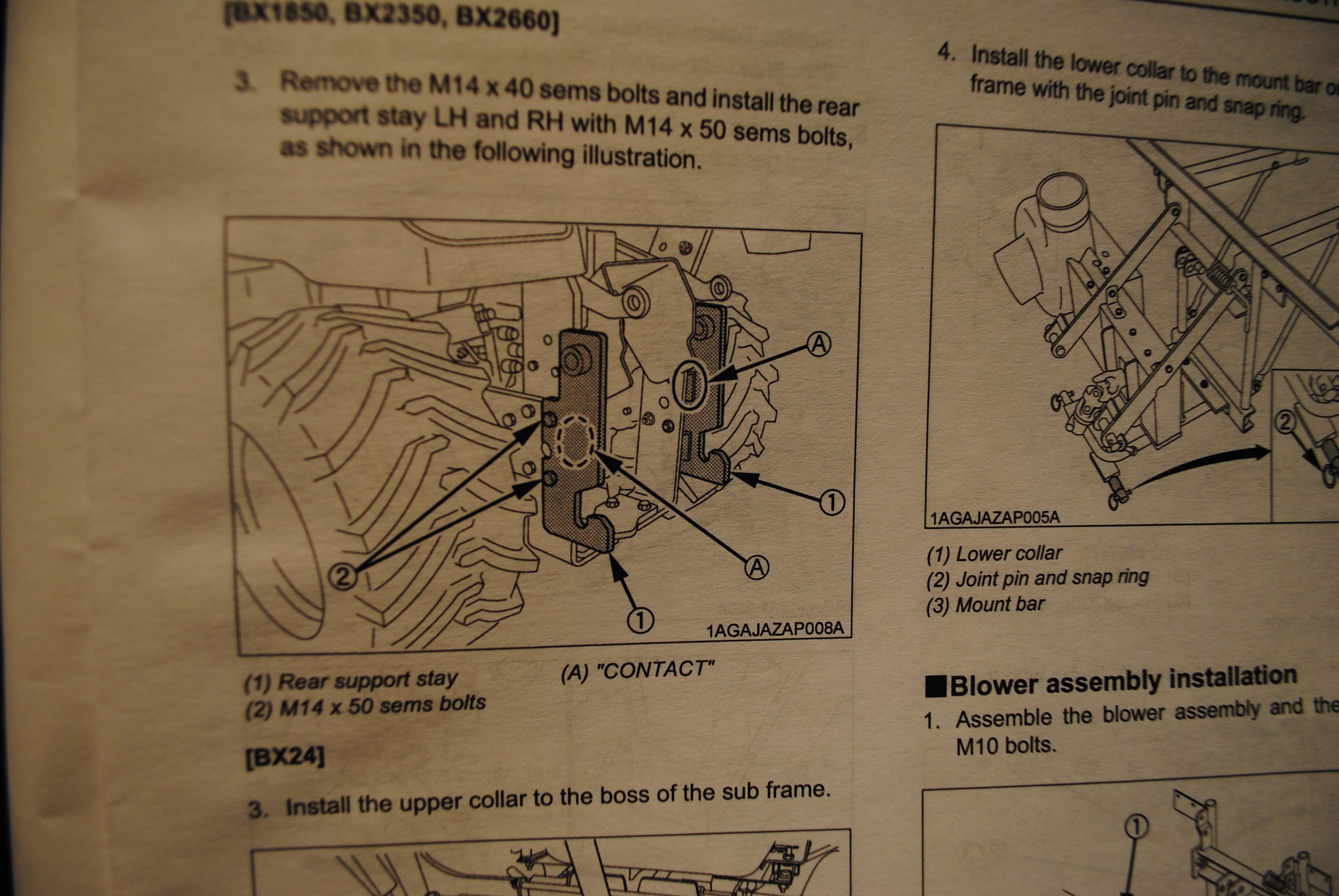

Just got hold of a used grass catcher for my 2350. Can't recall the model (it's the right one for the tractor though.) it's the larger collector with the hydraulic opening.
Anyway it didn't come with instructions. I have bolted the mounting plates onto the frame just inside the rear wheels. To me they look like they need to mount with the mounting point on the plates pointing to the rear. However I have spoken to a couple of dealers who say the mounting plates should be mounted as to face away from the rear. Anyone shed any light on this?

Does this help?.. The pic is from a GCK60-23BX owners manual
