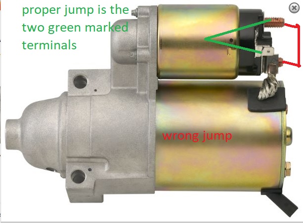

Do you know how to jump the starter? Remember, doing so bypasses every safety device and can get you or someone else hurt or worse.
If the engine starts by jumping when it wont start with the key you have learned a lot.
