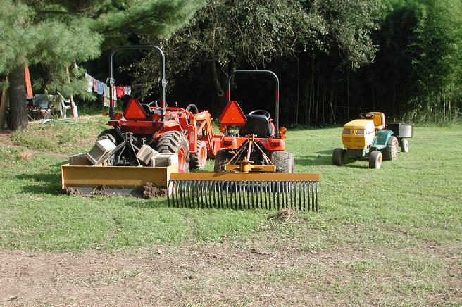

Since you have a MTD similar to my 20HP one, and are asking about a 2230 similar to my BX2200, and are being referred towards a B7800 similar to my B2910... /forums/images/graemlins/smile.gif
No doubt in my mind that you want a B7500 at minimum if you can afford it. The BX does not have the same 3ph capacity as the B7500 and bigger.
You can put implements on a bx...but the landscape rake I have on the bx in this picture can not be rotated around unless I back over a dip or a bank, so it can swing without hitting the gound.
My standard size post hole digger cannot work on the BX 3ph as it sits right now. There are modifications that can be made [which I hope to do when the weather warms] that will increase the lift height of the bx 3ph. But with the larger tractors you don't have to modify anything.
My self and others have started looking at the BX and ended up with something bigger. For me it was the B2910 first, and the bx second. If I could only have one...well, the B2910 is my tractor...I guess the BX is my boy... /forums/images/graemlins/blush.gif
