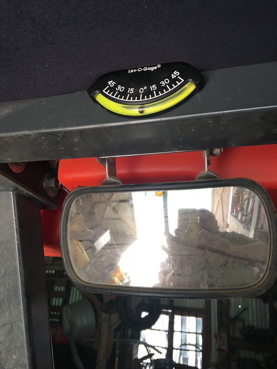

3) Many folks have inclinometers or ways to measure hillside slopes. If you were really that hot on the topic you can mount one on your tractor which would be foolish since you have no real business operating in steep side slopes to start with. It is called "judgement." You can also download an image of protractor and print it out on a piece of paper and use a paper clip for a weight and a thumbtack for the pivot and measure a slope for your self. Fun to go around and measure the slope and see the numbers for what your eye tells you is steep.

Tilt meters help to give you an idea but would not rely on them to prevent rollover. Too many variables and changing dynamics. Go low and slow.
