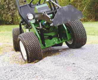

Just curious....how is the 12 degree up and down articulation controlled and where would it be of use?

The “up and down” articulation allows the front wheels to operate on a different plane than the rear wheels. See the attached picture. The advantages are two-fold: 1) traction is enhanced as all wheels maintain ground contact longer in rough terrain and 2) ride is better because the rear moves independent of the front. As I understand it, there is no "control" to the up and down articulation. It moves freely as the tractor moves.
