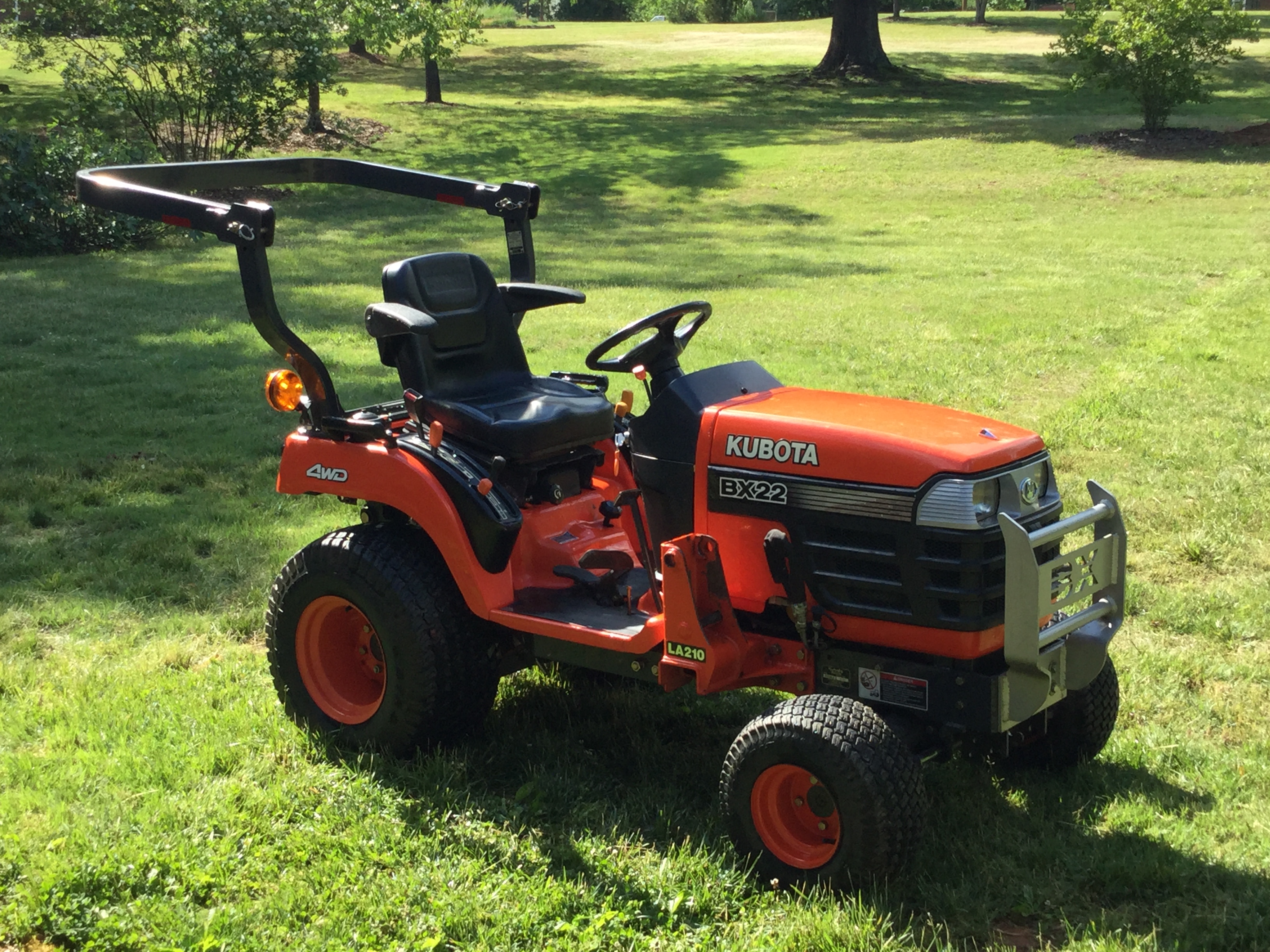

Got this one from Messick's last spring. Easy bolt on, no drilling. Found the armrests online. Much better than original.

I replaced one for my Dad's BX2200. Years ago there was a replacement program for these seats with a much improved version. The first part number Messick's gave me was a bit cheaper, but didn't fit. The underside interfered with the original seat slider/support brackets. Had to go with the upgraded seat, which has a higher back and thicker seat cushion. It also accepts arms, which are purchased separately. Ended up buying the arms also. Significant improvement over stock.
Here's my notes I kept when researching back in Nov 15:
K1253-56100 $92.01 This is the replacement for the original, but not certain if it addresses the sliding forward issue. This did not work on my Dad's BX2200.
B1013 $149 Is the seat used years ago to fix the sliding forward problem and is known to solve it. This is the one worked! (This is a Wholegoods part number)
Hope this helps.
