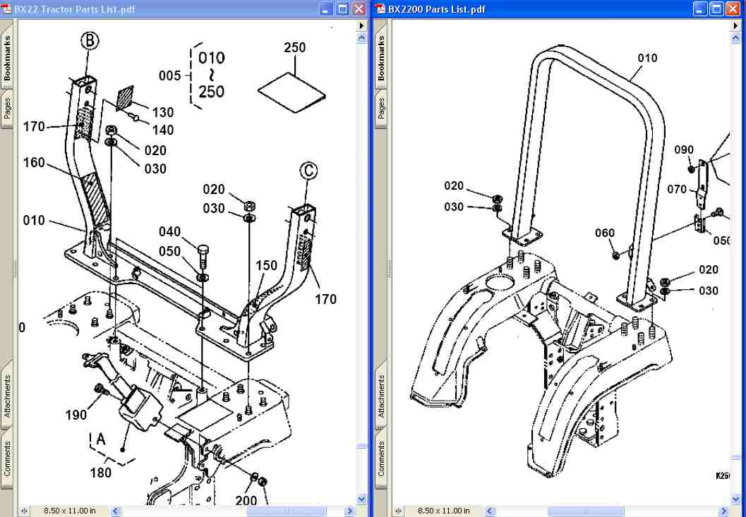

I noticed the newer models with backhoes come with a fold down ROPS. This has been a desire of my since first purchasing my BX. It would make my storage situation much better if the ROPS folded down.
It looks like the fold down version would be compatible with the older BX2200. My dealer says not. Does anybody know any different??
   / BX2200 ROPS #4
I'm not sure the bolt pattern is the same (I might be wrong), but I do know the BX22/23 has a cross member that attaches to the differential housing. The 2200/2230 does not. The BH model ROPS is also taller to provide more head room.
This has been discussed several times before; if you search, you will find several threads about it.
Ron
   / BX2200 ROPS #5
Attached are the 22 and 2200 ROPS side by side. Note the 2 extra bolts on the 22 ROPS. I believe the 4-hole bolt patterns in the fenders are identical between the two tractors since the fenders share the same part number. The spread between the 2 bolt patterns may or may not be the same (but likely are).
I did not research the previous discussions on this question to see if anyone actually tried it or not or contacted Kubota directly to ask, but it looks like it may actually fit - you just wouldn't be able to put bolts in the 2 innermost holes on the ROPS.
It's questionable if anyone would sell you one to try it out; and take it back if it doesn't fit. It may be cost prohibitive too.

A ROPS from a BX23 costs $650.
Based on the first page of this thread it won't fit. Someone took measurments between the two and they aren't the same.
   / BX2200 ROPS #7
I would be willing to bet that the two, four-bolt patterns are the same, as are their spacing and the additional two bolts (#40 in the picture) attach to a piece of the BH sub-frame which could also be added if you wanted.
I would agree that the cost would be prohibitive to do a retro-fit, when a better/stronger ROPS could be made by an independent Fabrication shop with the features and size required for less money.
