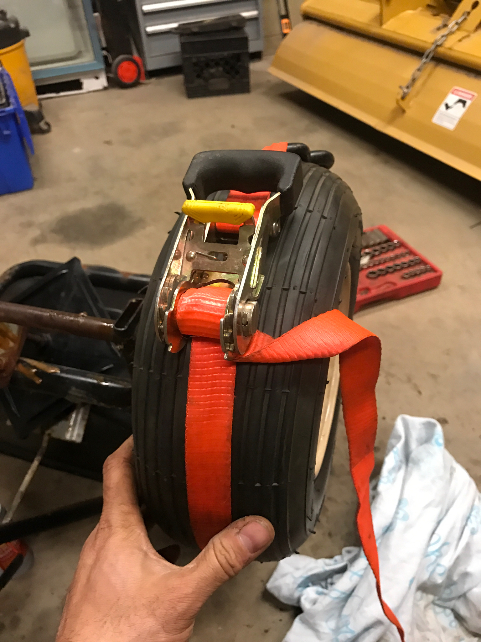

I changed out one of the tires on Saturday. I was able to get the old tire off, a new valve stem installed, and the new tire on without much effort by hand. However, I could not get the tire to bead...tried multiple times with starting fluid (it beaded 2-3 times, but quickly unbeaded before I could get air in it). Took it to a shop and they filled it with air.
Anyone have a trick for getting tires to bead/seat? I also tried wrapping the tire with a rope, but that didn't help...
   / BX2200 Rear Tires #2
I do heavy ratchet straps around the center and cinch it tight, start adding air until bead seats and only add a small bit after so you can unlock the ratchet strap and then fully air it. Do all my small and medium size tires this way. IMG_1817.JPG

Yeah if the tires are real wide or with the heavier plys like that sometimes a ratchet strap won't cut it. Worth a try, I have equipment straps that I use for the medium tires, they will take a small bar on the handles to cinch if necessary.
