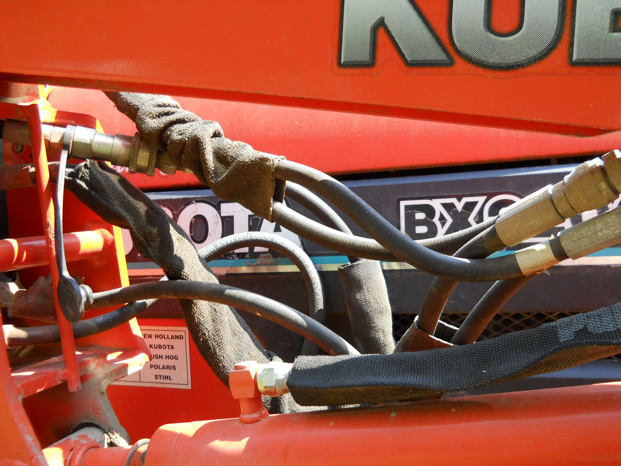

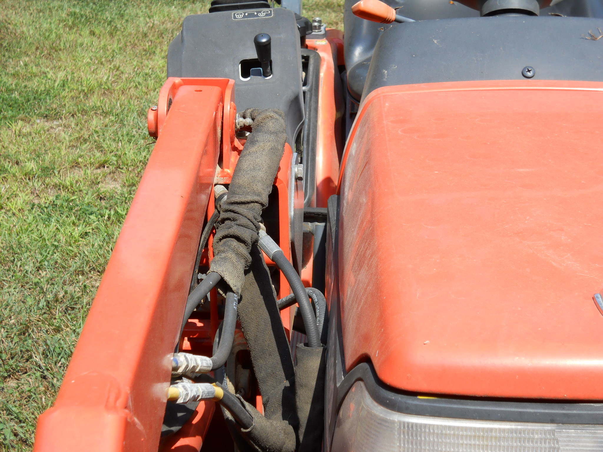

I'm a bit confused, the LA211 won't fit on a modern BX, I have a BX2200 and BX2660. Is yours like this? If you don't get and exact seal on the return line, it won't budge.
