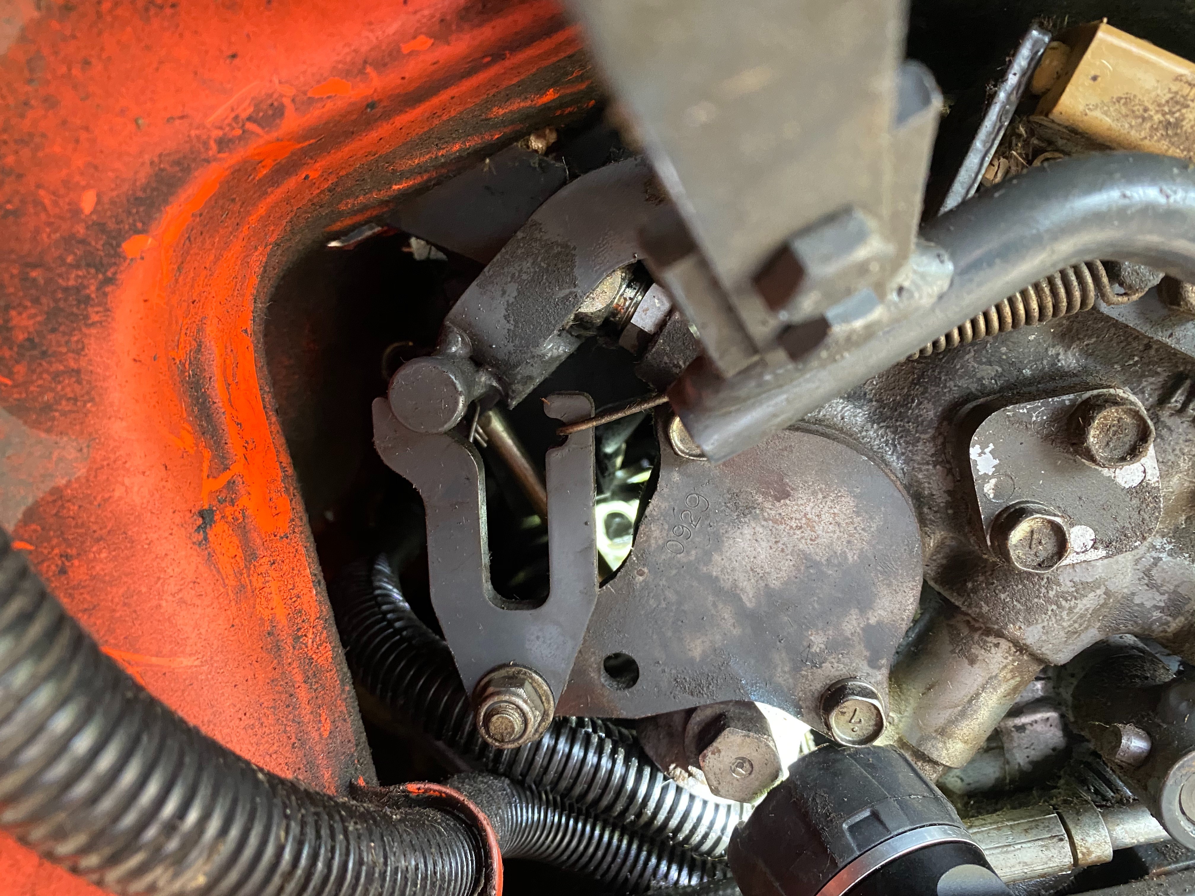

My BX2200 had a puddle of Hydraulic fluid under the rear end. After cleaning and checking everything it appears the oil is running down the sides of the HST and is coming from the top HST vent (out the two side threaded holes at the top of the HST). I looked through the manuals and diagrams, not sure 1) if there should be fluid in this section of the HST; and 2) If there is fluid in the front section how it is returned to the reservoir.

I knew I left information out. There was no oil on the dipstick, the HST and steering were non-responsive. I filled it to mid-way between the two marks and the HST and steering are responsive now. It is still however pushing out a very steady drip that is coming from the two side holes at the vent on the top of the HST. I am including pictures as well, both pictures are from the right side (side with the control valve and pump).

Also, in looking at the diagrams it appears the actual vent is in the center of the top, and that area is open. While I could not see any fluid coming from anywhere else, it may be possible that it is somehow getting in to the "moat" around the vent and coming out the two side holes. (somehow that seems like a poor description but it is the best I can think of at the moment). I attached pictures to my response to the prior reply.
Really appreciate all the time and assistance. The parts diagrams and workshop manuals are helpful in many cases, in this case I am either missing something or there is more to the story. I am not familiar with working on HST transmissions, I have a limited understanding of their function at best.
