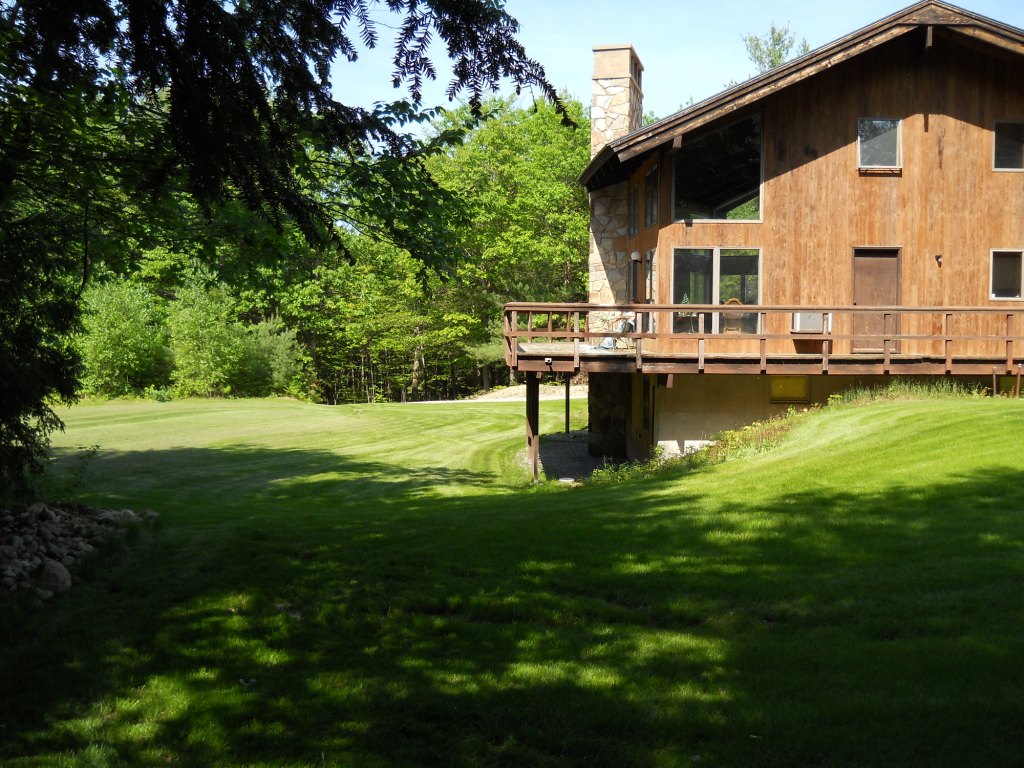

:welcome: to TBN. Not sure what your hill looks like, but keep in mind that most tasks should probably be done in low gear. I have a 20+ degree hill and mine won't even begin to climb it in high.
20% is pretty steep - that's like expert ski run steep. My BX2200 climbs a ~25% grade (6ft up in ~25-30ft) with no problem - doesn't look steep in the attached pic but it feels steep going up. My worst issue is the rears breaking loose and burning a stripe in the grass up the hill...and that is in high, pedal mashed to the floor, with MMM running.
I've been meaning to look for the HST fan - no clue if it is still intact.
   / BX2200 HST get HOT? #10
I did specify degrees, not percent. I measured it at about 22 degrees on the steepest part while parked across it. Pucker factor is pretty high with the fel on, not so bad naked.
