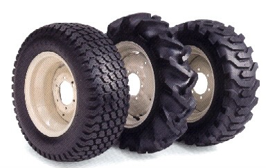

   / BX2200 for 3.6 acres with incline? #6
When I made my decision I decided that getting a tire which would handle my FEL was more important than getting the best for the grass. I eventually landed on the R4's which set me back an additional $150 over the turfs and barturfs. I was told that the turfs (my origonal choice) didn't have as thick a sidewall for the heavier lifting and was told that the R4's would also last twice as long as the other choices. I am very happy with the minimal impact on the lawn but I also don't have any damp areas. Also, when my dealer prepped my tractor he filled the rear tires with liquid ballast.
Jeff
2001 B7500HSD, LA302 fel, 60"mmm, grass catcher
   / BX2200 for 3.6 acres with incline? #7
Tires from left to right are turf, bar and R4's
Jeff
