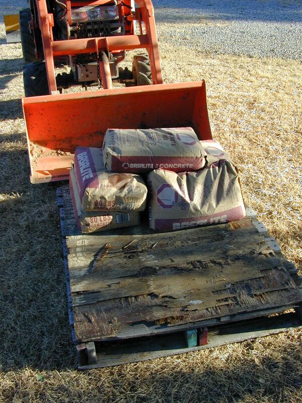

I don't have a direct answer for you but, if the search function works right today, there have been a couple of old posts that did tests with sack crete bags in the bucket ... seems like the result was over 500#.
Attached is a pic of my '23 ready to pickup a pallet using bucket forks. That's 6 80# bags of sack crete ... obviously piled strategically. I could lift it about 1 foot ... which was all I needed :)
