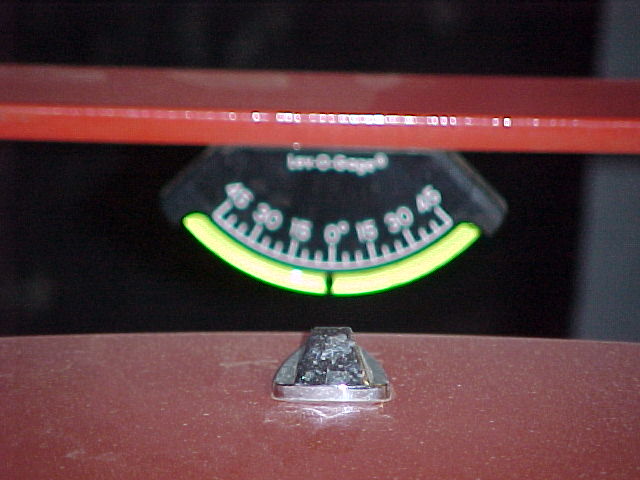

i'm sure this has been talked about; however, i just received my tiltmeter and want to put it on my bx2200. what have others done? There's no apparent first choice of a place to put it.

I mounted my tilt meter to the grill guard on my BX2200. This seemed like the best position, as I am always looking ahead at the loader or for objects when mowing on slopes. I will post a pic as soon as find my camera the wife borrowed.

I also have my tiltmeter mounted on top of the FEL grill guard at the front of my Kubota (B7500 HST). To mount the tiltmeter, I simply used a strip of double stick tape (the thicker type - sometimes sold to mount posters) between the bottom of the tiltmeter and the top of the grill guard. It has been over a month now, and the meter is still solidly in place. This seems an ideal location because the tiltmeter is always in my line of sight as I'm driving.

Charlie,
I mounted my tilt meter under my grill guard to offer some protection. I used a two part epoxy to glue it. It has been on there for four months now.
TractorTim

Close up picture.
