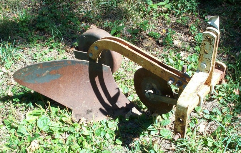

1 Bottom Plow...
Charlie,
One of my buying mistakes {long story}, anyhow, 12" as seen but CAT 0, you can convert... $95. + shipping ???
"You are what you eat, drink, think, say and do..."

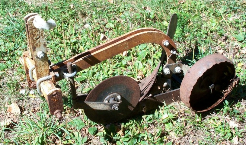

Another angle...
