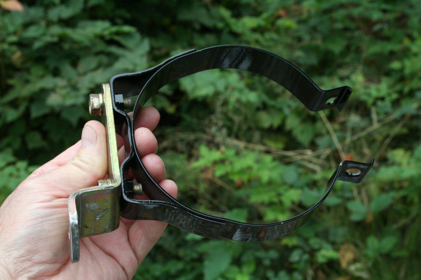

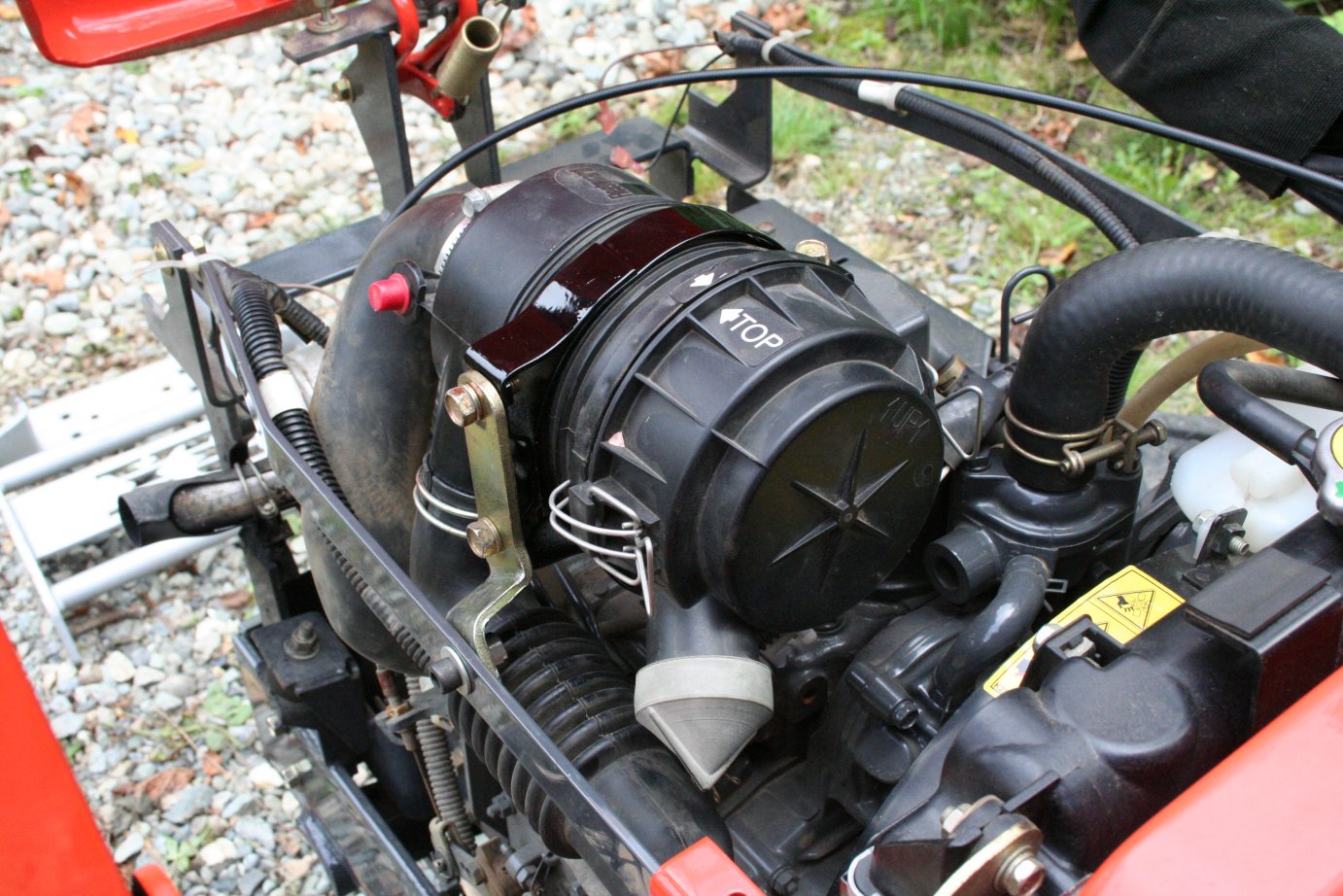

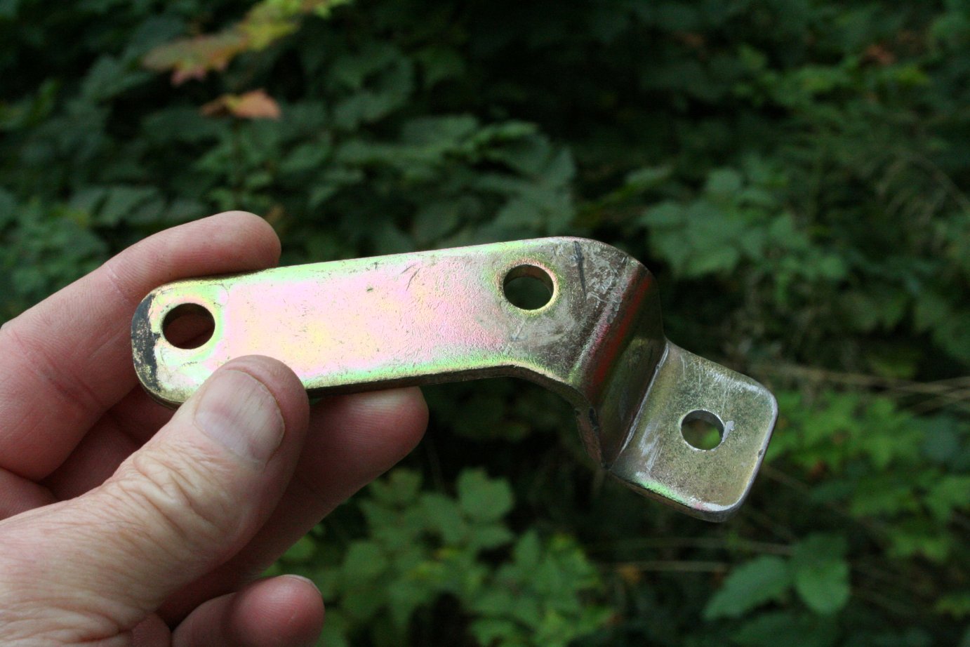

I'll assume that the BX2200 air filter bracket is simmular to my BX23. In 400 hours, mine has broken four times. Twice it was the lower bracket and twice it was the band that goes arround the air filter housing.
At 400 hours, I decided to re-engineer this poor design. I now have about 40 hours on the repair with no trouble.
The first picture is the bracket I made from the original piece that mounts to the engine. In the second picture, the bracket and the air filter clamp are bolted together. There was a conviently located hole in the rail that runs down the side of the engine surround that positioned the air filter assembly in the same position as it was, when attached to the engine. The intake tube lined up perfectly with the new bracet.
There is a little vibration that is passed through the rubber intake tube, but nothing approaching the violent vibration of the original mounting location. I hope you find this post helpful.
