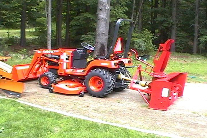

Just wondering if ya'll consider digging dirt (till the wheels spin) abuse when done within the first 15 hours or so of a BX's life? I really want to do some digging and actually have done a little, but don't want to do any damage to it during its break-in period. It is such a fantastic little machine and I don't want to screw anything up for the long term. Thanks.

That is the BEST Snowblower I've ever seen... Not only does it remove all the snow, but makes the grass <font color=green>green</font color=green>... /w3tcompact/icons/blush.gif
/ BX2200 Abuse #3
Ow, my neck! Always wondered about those rear mont snow blowers.

Dude!!, what the heckfire is that thing on the back of your BX!!! You planning on clearing a whole highway or what? I have to say--you do not fool around with half way do you? Properly impressed. J
/ BX2200 Abuse #6
Awsome snowblower, who makes it? what size is it? How bad was the price? I'm getting ready to buy one for my BX1800.

Ain't she a beauty. The thing is huge! I looked at it when I was at the dealer before they dropped it off and said "can that little tractor even lift that thing?" The dealer uses one at the shop and said "not only can it lift it, but it can blow 24" of snow (medium density) 50' at full speed in reverse (low gear). It's gunna make quick work of my 400' drive. By the way, I plowed last year and the snow piles by my garage were over 9' high in northern Vermont. It was a crazy winter, but I love plowing and blowing. This thing is gunna do me right.

It's called a Meteor made by Forage King. The corporate name seems to be MK Martin Enterprises Inc. R.R.4 Elmira, Ontario N3B 2Z3 Tel: 519-664-2752
I have been told that it is the best blower for the money. It was only $1150 here in Vermont (The alternative is the Kubota for just under $3000...no thanks). It's all there, as they say. It's actually a lot lighter than it looks....285 pounds.

Kubmech, It was inexpensive ($1150) and the alternative was nearly $3000 from Kubota. I'll deal with sitting side saddle for a half hour or less. It won't be a problem for me. I cruised around in reverse for awhile and it wasn't bad at all.
