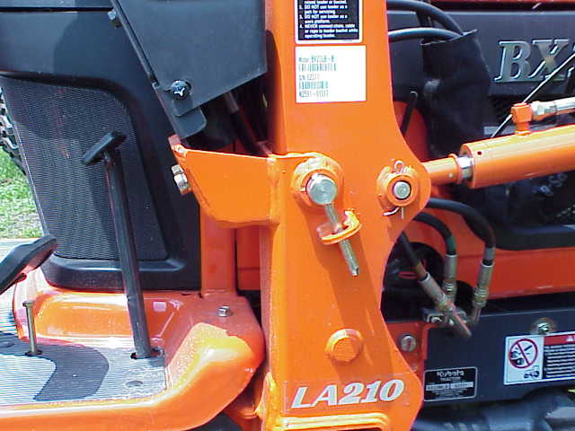

If you look at the loader on the side where the valve is, you'll notice that you can disconnect the loader without removing the portion that holds the valve/control. There are some pins that can be pulled to release the loader. You also need to disconnect the hoses with the provided quick links. They designed it this way starting with the BX22 for the purpose you have on the table.

I was at the Kubota dealer recently and took a picture of the valve on the BX23. It stays with the tractor, so I though about modifying mine to work the same. I figured that it would be as simple as welding on a bracket to keep the valve attached. The more that I look at the way the BX22 valve is installed, I can see that there is no easy solution to the problem without making up new hoses etc. After exploring all possibilities, I think that it might be cheaper to just trade up for the BX23 than to modify a BX22. If someone has any ideas, share them with us and possibly if we all put together our collective thinking we might find a way to devise something that will work. This picture is the valve assembly of the BX23. Note that the way the hoses come off the frame is different than the BX22. This is only one of the differences, and the least difficult to work around.
