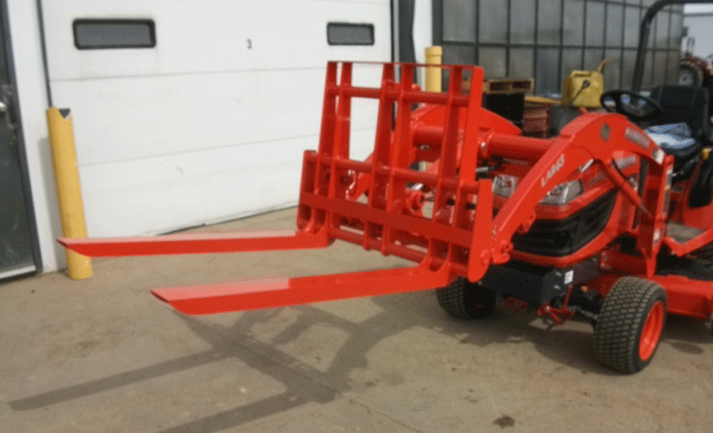

I have been looking at quick attach and forks for the BX.
Jerry at myTractorTools sells a lightweight loader quick attach called tach-n-go that does not require and modification to the bucket. It also incorporates a hitch receiver.
If you really need the weight back you can remove the tach-n-go. He also has a set nice forks of 110 lb forks.
/ BX1860 tires/wheels #10
Or... You could buy the Kubota QA and forks. The fact that the forks are fixed (can't move fork width) was a deal breaker. I really liked his QA design, but the factory one is under $300. I just ordered from my dealer, entire package $1200
