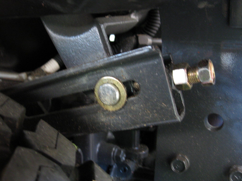

Check the deck-lifting arm that's a part of the 3ph mechanism.
This is the first lifting point . There's no priority involved in
any of this movement , it's just a case of if the deck or
the rear hitch load is first to contact the lifting mechanism ..........

On my BX2660 there is a pin that connects the linkage from the deck to an arm from the three point hitch on the left rear side of the tractor between the rear tire and the frame. There is a cheap clip on the pin that fell out on mine and caused this very same problem. If you have someone operate the three point hitch and watch (from a safe distance) you can observe the linkage and arm from the three point. My guess is you will find your problem here. Looks like OrangeRidge beat me to it.

OrangeRidge, thanks for the pic, that is exactly where the problem is. Like Cooldmax described, the pin fell out. I spent 10 minutes walking in circles on the pebble driveway and low and behold I found the pin!!!
Now I need another washer and a suitable R-clip, but that's easily resolved at the local TSC.
Thanks folks for your help. Honestly my heart sank yesterday and I was envisioning a trip on the flatbed trailer to the dealer. Luckily it was much concern about nothing at all.
