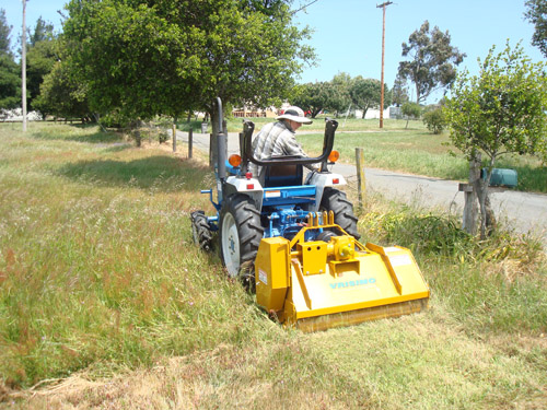

Another option is the Vrismo 46 inch mower in the picture i have provided.
I am unaware of its retail cost.
It uses the scoop knives and will mow to dirt in one pass.

leonz: Can you please post a picture of your flail mower? Looking at commercial ads doesn't do as well as an actual real live in person picture. That's why we like to see peoples tractors instead of just posting a picture from the Kubota Company web site. Come on leonz, lets see it.:thumbsup:
