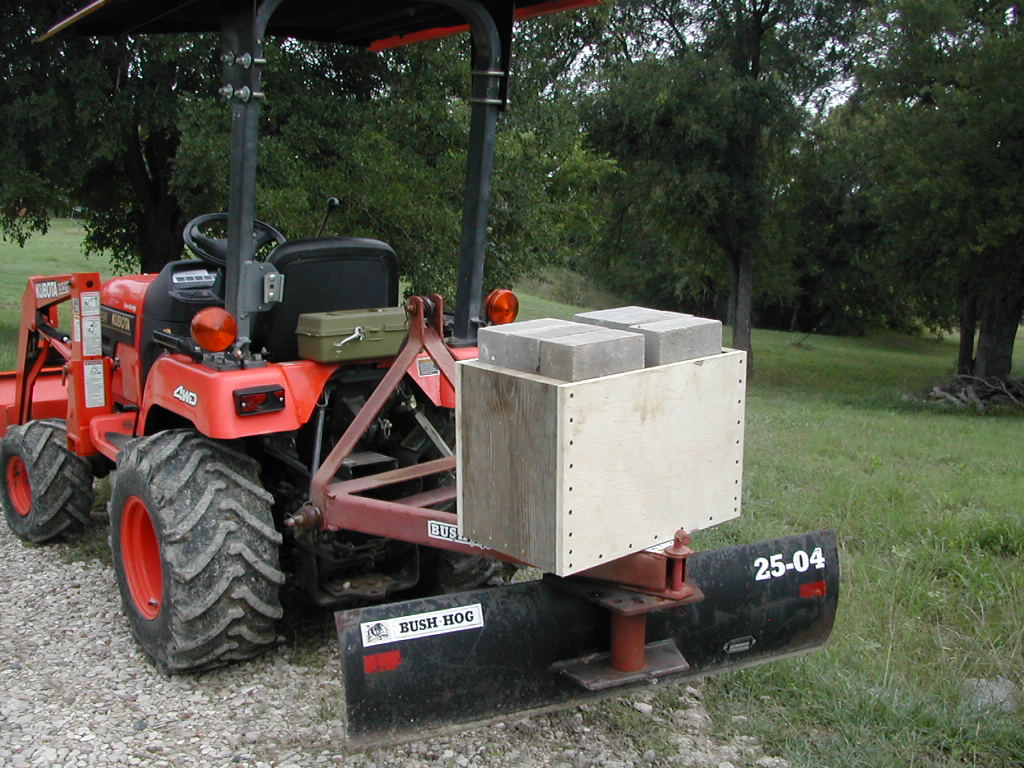

I have the BX2200 and made a wooden ballast box that bolts to the top of my 3 PH Bushhog blade. The box holds six solid, easily removed, concrete blocks (4"x8"x16"). Total weight - about 300 lbs, including the box. Makes the blade and FEL work better.

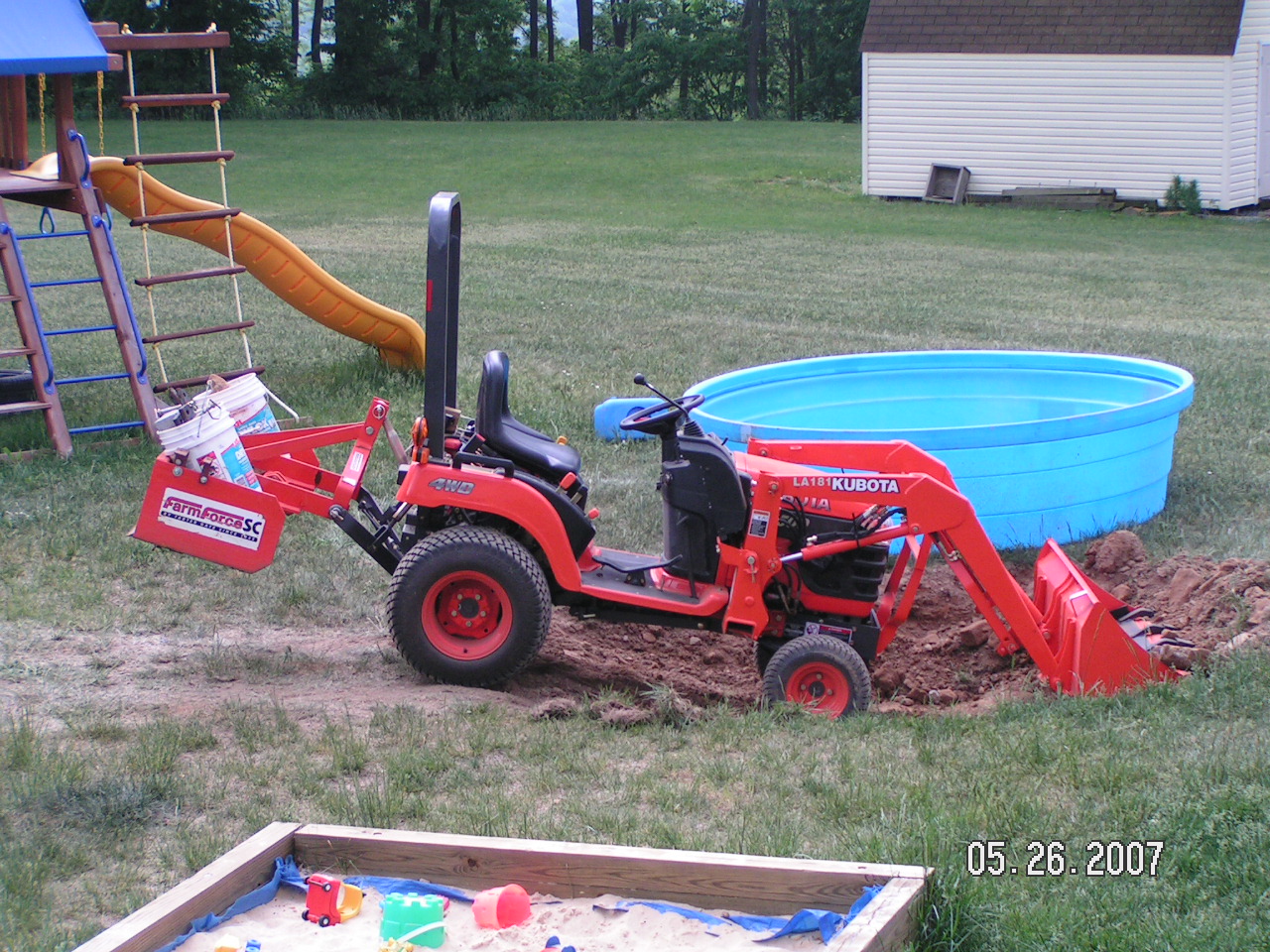

I add weight to may box blade when digging or moving heavy material like gravel. In the pic you will notice 2, 5 gallon buckets on the BB. I filled them with rock. I figure they go about 90lbs a piece which brings the total hanging off the back to around 430lbs.
