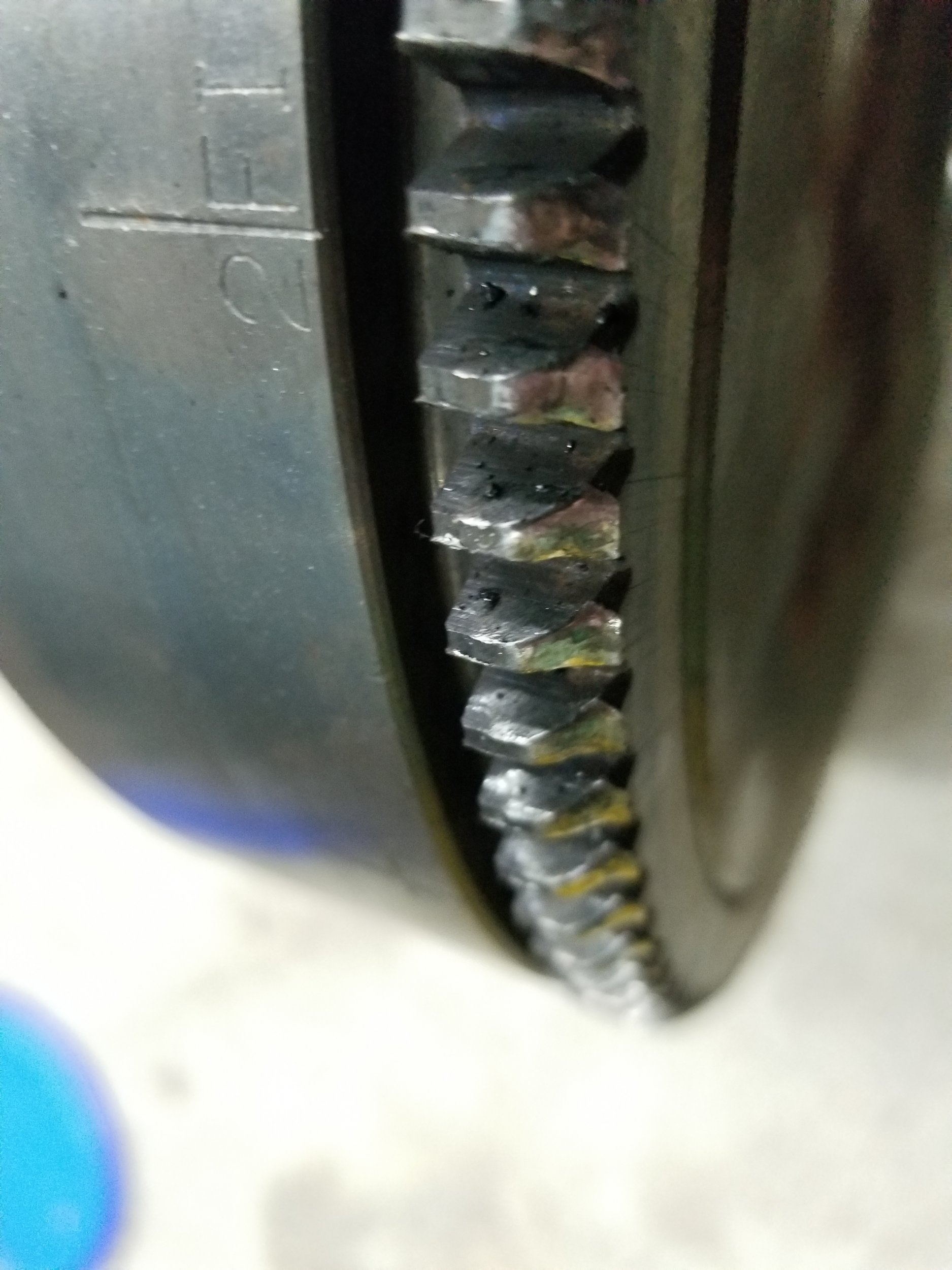

Next time this happens turn the engine a bit by hand. If it starts then you could have a worn ring gear. You could also take off the starter and turn the engine by hand. This happened on my b8200. A new starter would only have worked for a few weeks.
