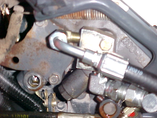

I received part #75538-68110 block, with two tapped holes. I installed a single spool valve with power beyond, and now my 3 pth arms will not lift unless i pull handle on remote valve to turn the orbit motor on tiller i have attached to it.
