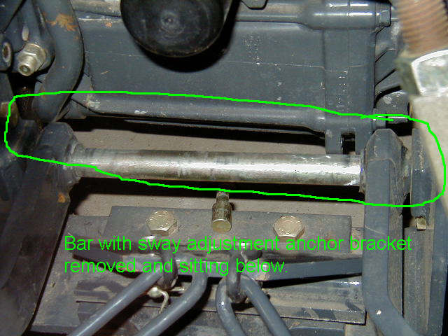

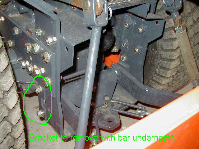

Steven,
I would be interested in seeing a picture of the BX22 3-pt arms set up. My set up is a rod through both 3-pt arms and the sway adjusment anchor bracket (if that is what it is called). I tried to remove today, as I thought it would be easier for trailerin. It appears that both of the outer sides have a bracket you can remove which looks like you can then pull the bar out and slide the 3-pt arms off. But upon removing the holding brackets and trying to tap the bar with a hammer (sideways as there isn't much room between tire and bar) I found that it didn't move easily. I decided after a few minutes not to proceed as I did not want ot get it part way off and not be able to put it back on easily. And I surely didin't want to remove the tires today.
Anyhow, if you have a picture please send. I will attach a few of mine for reference as well.

Here is another showing the bar with the sway adj. bkt removed.

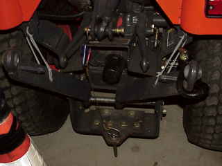

Dwayne
I have the same issue with the 3pt hitch. The way I solved
the problem was to remove the linkage for the hitch
and tie up the arms with cable ties. This allows for small
lawn trailers, etc to be pulled, by if I need the hitch
it only takes a 2 or 3 minutes to put it back see attached

Hi.........
On the BX22 3pt., the pine you are talking about removing is in 2 pieces, with enough space or gap between them that allows the lower arms to slip through. The pins stay on the tractor even with the hoe mounted.
I had bought the service and parts manuels for the BX2200 and then traded tractors for the BX22 but didn't buy the BX22 manuels so I can't give you the part numbers. I would just talk to the dealer and see if they now have changed them all (BX22 and BX2200) or if the parts could be changed? Hope this helps.
