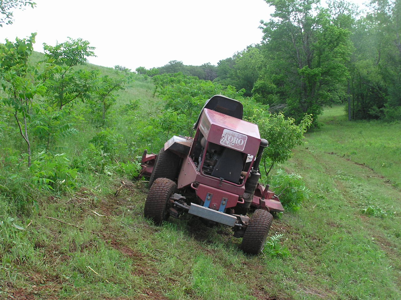

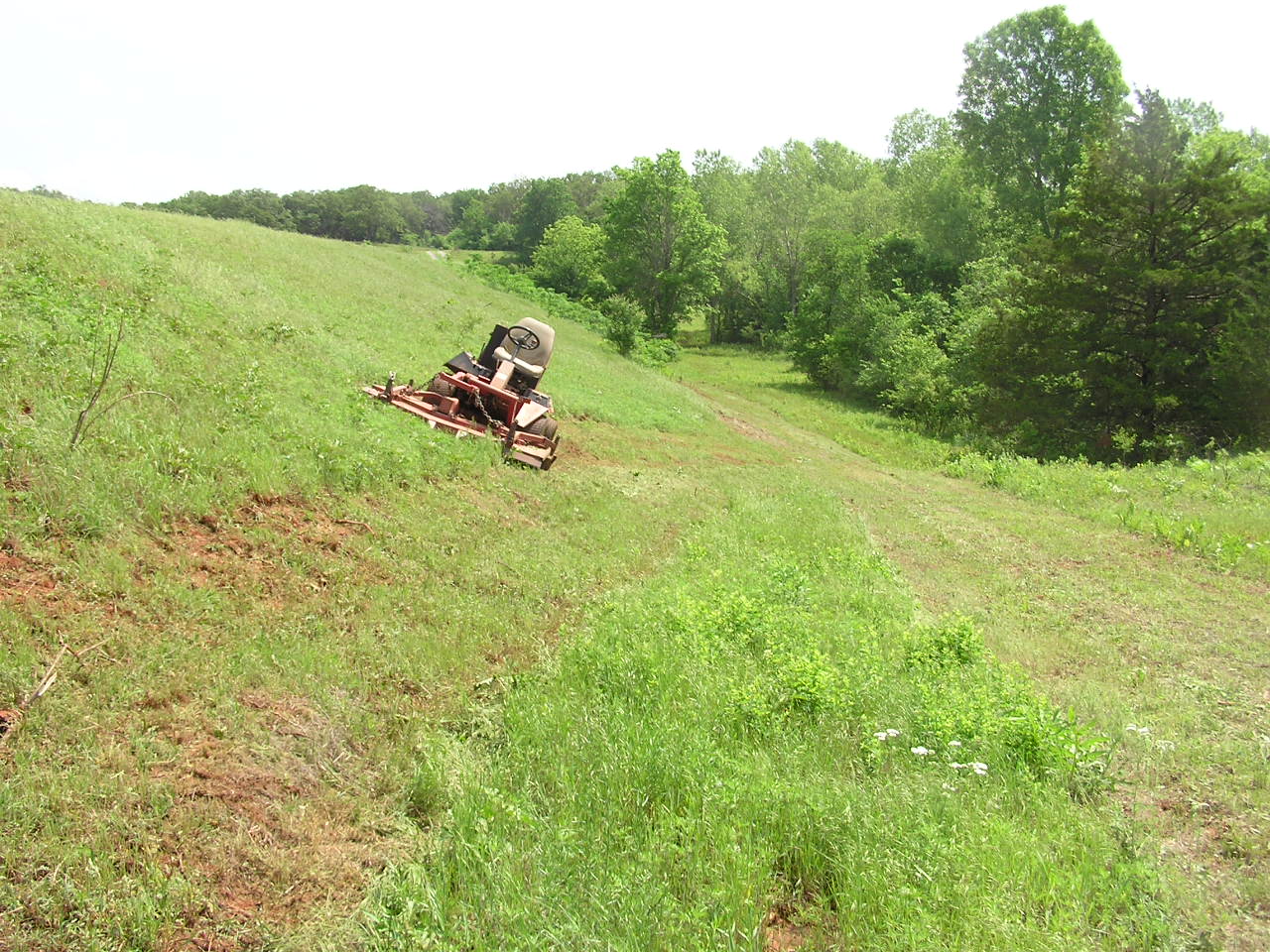

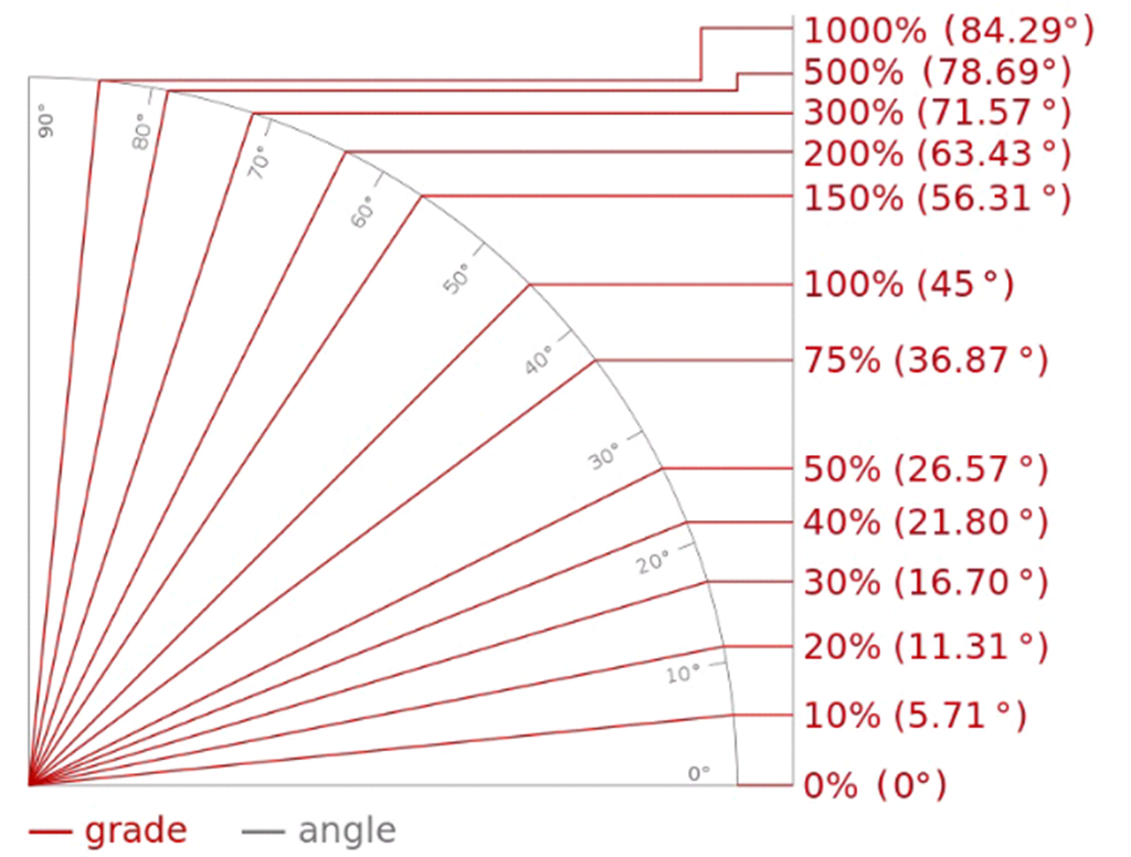

13 degrees isn't very much. Have you tried mowing sideways?
I mow a 26.6 degree slope sideways with a 6' front deck 4 wheel drive TORO.
