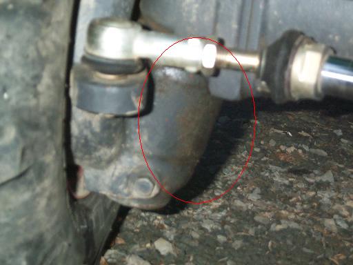

Anyone else with same problem. I heard the seal/washer
may have to be changed or was recalled??
   / bx1500 small leak by front axle #2
I have many be the same problem you have, it leaks at the pivit seal. I had tighten the bolt and it stopped til I plowed snow 2 weeks ago, then it started again but not as bad as before. Lets see how many respond this thread.

   / bx1500 small leak by front axle #6
Here is what it look like on a BX22, Dealer put new seal & press it back together. good as new! /forums/images/graemlins/grin.gif
   / bx1500 small leak by front axle #7
Blow up view
Was the seal under warranty. If not, what did it cost?
Do you have the exact name of the seal and exact location.
Your red circle is around the gray four wheel drive resevoir or is the seal behind the bronze nut above the gray resevoir?
   / bx1500 small leak by front axle #9
Ct,
Bought mine new May, 2004.
   / bx1500 small leak by front axle #10
The seal was replace under Warranty /forums/images/graemlins/grin.gif
The seal in question is behind the bronze nut on the pic. (wet area). This is part of the axle pivot steering.
